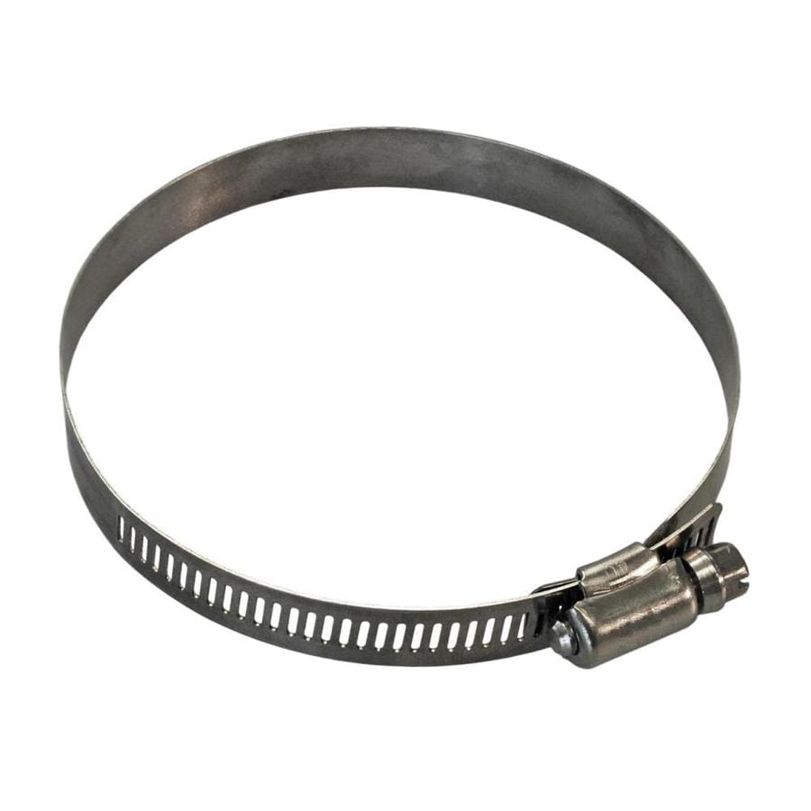

Tensioners should be on the bottom of the chain run, not on the top.
Replace the mickey mouse wire on the muffler with a clamp or two.
Would taking off the tensioner and shortening the chain work though that’s what iam asking. Thanks for the advice I’ll get to replacing those as soon as this tensioner thing is fixed.
