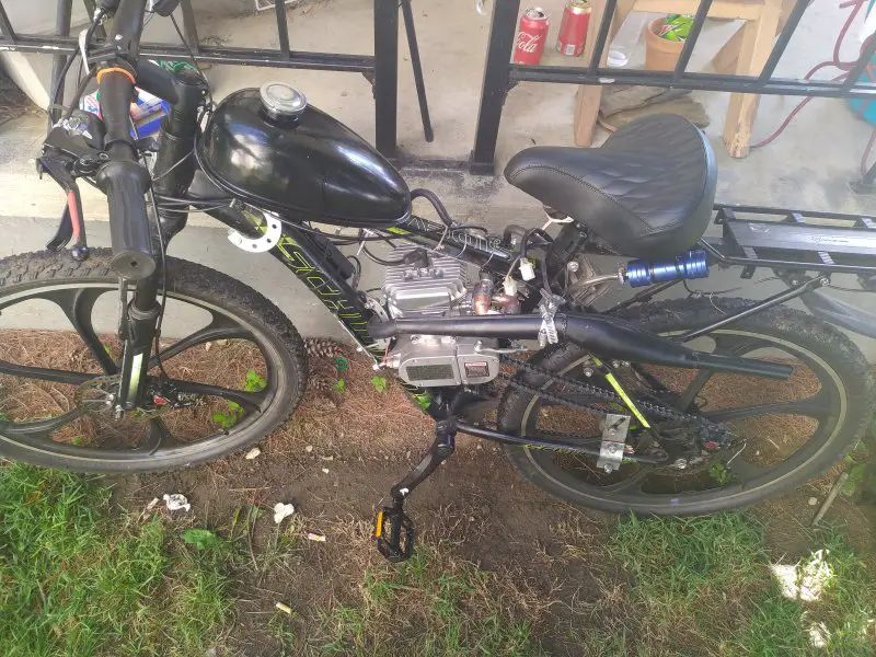

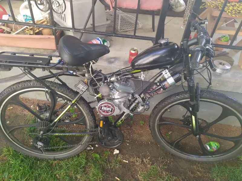

This my bicycle I been working on, if you like hit the like button <3

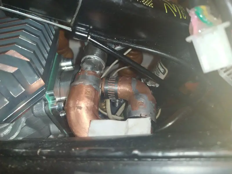

Minarellie vertical with bikeberry F2 thrust exhaust
Car muffler shop welded it for 25$ over night
So question 1

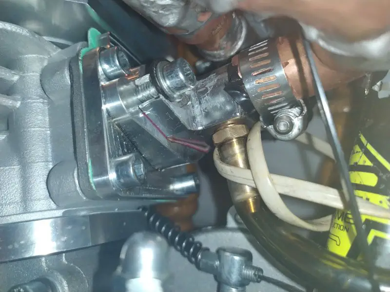

This bicycle engine is not broken-In and goes about same speed as my broken-in 40mm stock China girl? Is it because I'm using the stock China HP carb with single jeting?
What carb would you guys recommend carb intake is a stock modified 40mm carb,I just dremeled it out ;)
Quick blow torch

Also thanks to as smolik performance for the awesome spacer, the geometry for The cylinder 39,2mm stroke of any cylinder for the most part I assume can be used :)
My honest advice...
That intake is a nightmare & is going to be very restrictive at higher RPMs.
That expansion chamber pipe wont work... get a pipe from a 80cc motorcycle & modify it to fit... (be sure to keep the factory length).
I would get rid of that large coil & use the small one that comes with the CDI.
Those boost bottles are a joke... (they don't work)... get rid of it.
It might be easier to find a taller frame bike so that you can use a short intake.
Any carb will work with a reed valve, but you have to install bigger jets.
