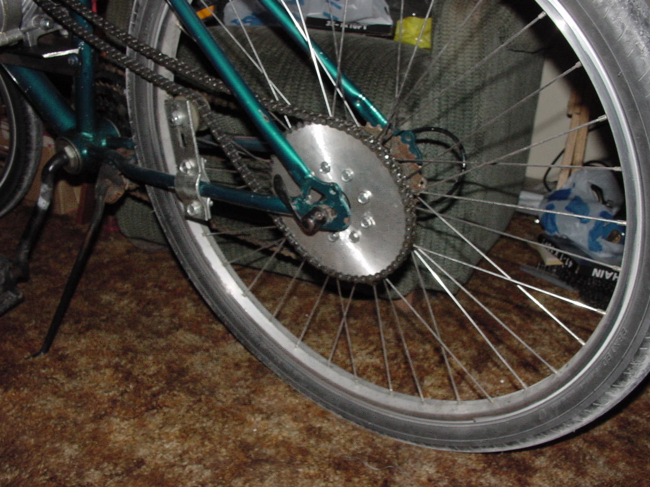

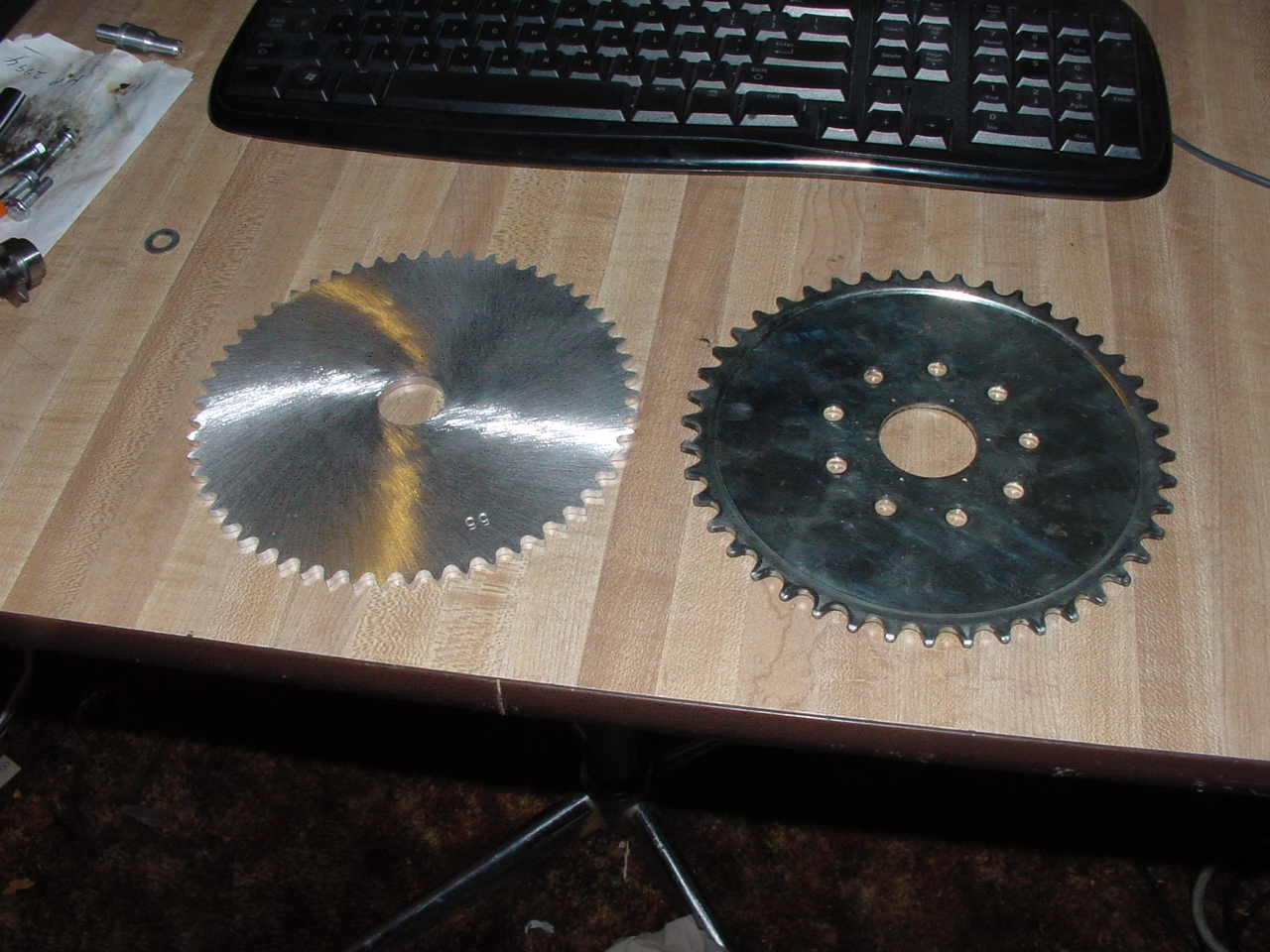

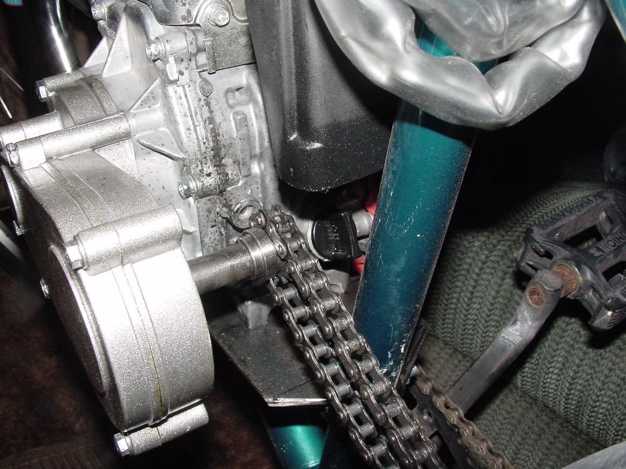

update: i replaced the output free wheel from 12 tooth #415 to 9 tooth #35 non free wheel gear and a 55 tooth #35 sprocket on rear. 18.3:1 ratio
it rides well, can start from a standing start no peddling. so i went and find some hills for the next challenge, 3 miles from my house i a good testing hill.
this hill is at a 19+ deg angle, the clime is about 600 feet to about 200' foot grade improvement.
it slowly climbed right up the hill at 10mph
by removing the free wheel we have no free wheel now, so coasting with engine at idle is out.
this will hurt mpg because we have no free wheel.
on the plus side, we now have engine braking this is a good thing.
if you have older side pulls ect, extra braking is good.
good luck all

That's great news. I hope it lasts! The engine braking is the thing I miss after switching to the shifter version of my transmission. Anyway, good news, keep us posted!
