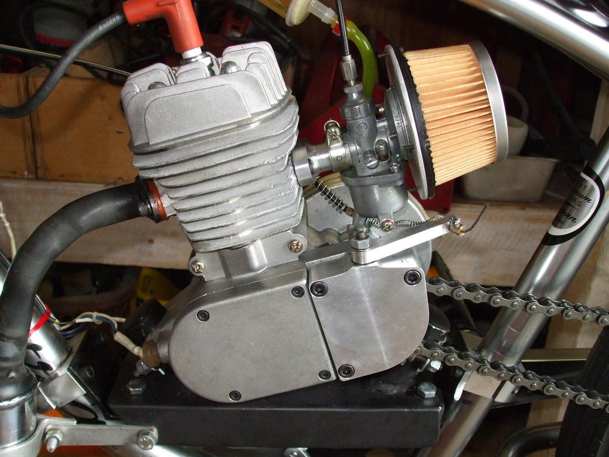

I have a Electra Stretch alum. frame coaster bike and a Dax F80 engine.The mount is made of brackets made from 2x2x3/16 steel angle,the engine mount is 3inch by 3/16 channel. The engine is mounted to two 1 inch sch. 40 tubes welded to the channel. The channel is bolted to the brackets four 5/16 bolts with 1/4 rubber spacers. The frame clamps were from Jim the Manic Machanic. I have been useing this mount and it kills alot of the viberations and was easy to build.
