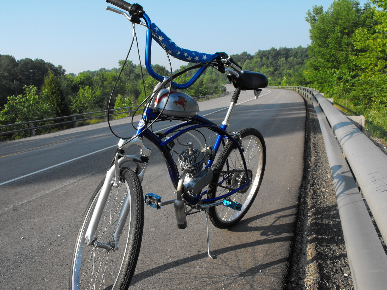

Default Re: Vibration tip
These bars are 7/8 but have 1 inch center and the flat ends on the upper bar, that go through a one-piece gooseneck (you can't see under the pad)- they were only about $12 I think.

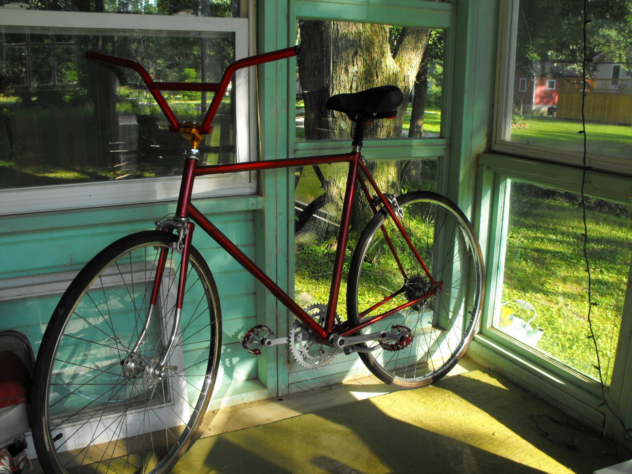

This is a Schwinn I've built up- with MX bars- 7/8" all through, that requires a 3 piece stem-
the stems come in different sizes, but most of the quills are 2.11 mm or 2.22 (7/8") and rare 2.54mm ,(1 inch)-
These annodized retro like this one need to be shimmed in most bikes- I just use tape- although I'd go only one size down- and this Schwinn takes the small quill anyway, but the one in my Peugeot road bike is taped-
Gold here, the Peugeot has a blue, and they come in red too- very lightweight and I love the look-about $20 shipped on e-bay under "BMX stems"
I raced USCF in my younger days, but at 55 and with some back troubles, I really can't ride drop bars any longer.
