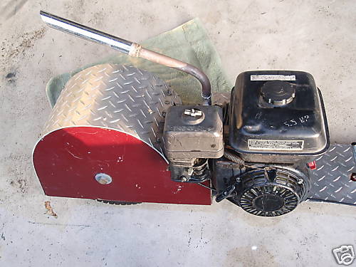

After researching and pricing I came to the conclusion that it would be cheaper and faster for my to buy a riding device for cheap and salvage it for a push trailer.

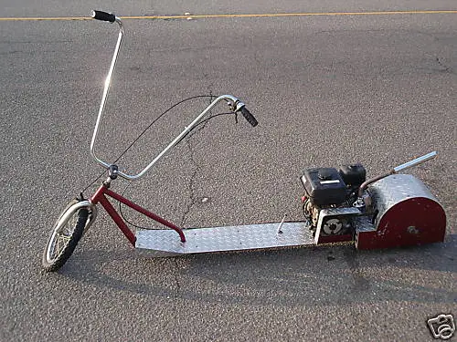

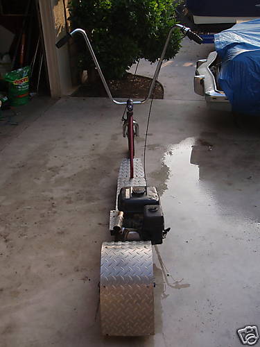

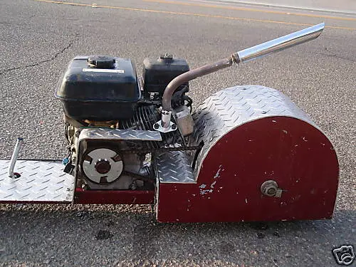

Here are some pictures of the push trailer that I purchased from ebay fro $150. Fun but DANGEROUS with a 5.5 real honda engine and a 6" wide rear tire.

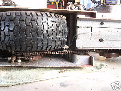

Edit: Completed now with a 6.5 clone engine as the genuine honda died. I never checked the sprocket but from the picture below it is a 60 teeth sprocket. The rear wheel is a 15" tire and the clutch is a 12 teeth #35 chain. Gauged at 44 mph before approching a stop sign.
Future enhancements my include a thicker 2 inch pipe as this pipe feels as if it flexes under heavy acceleration.

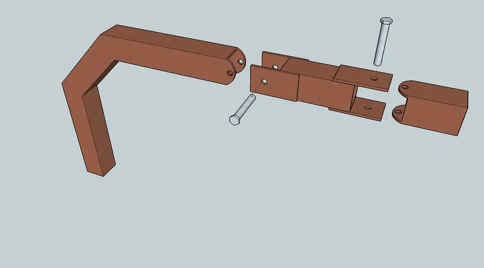

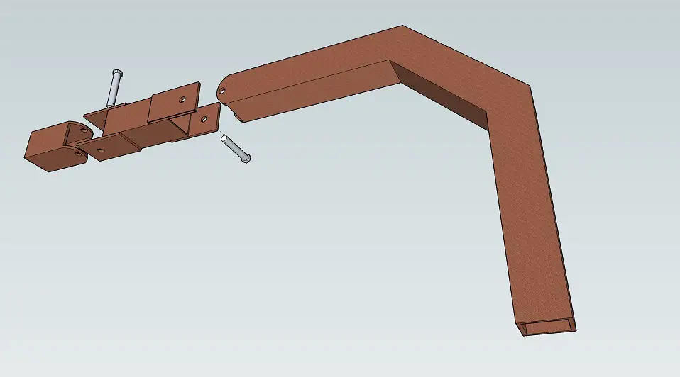

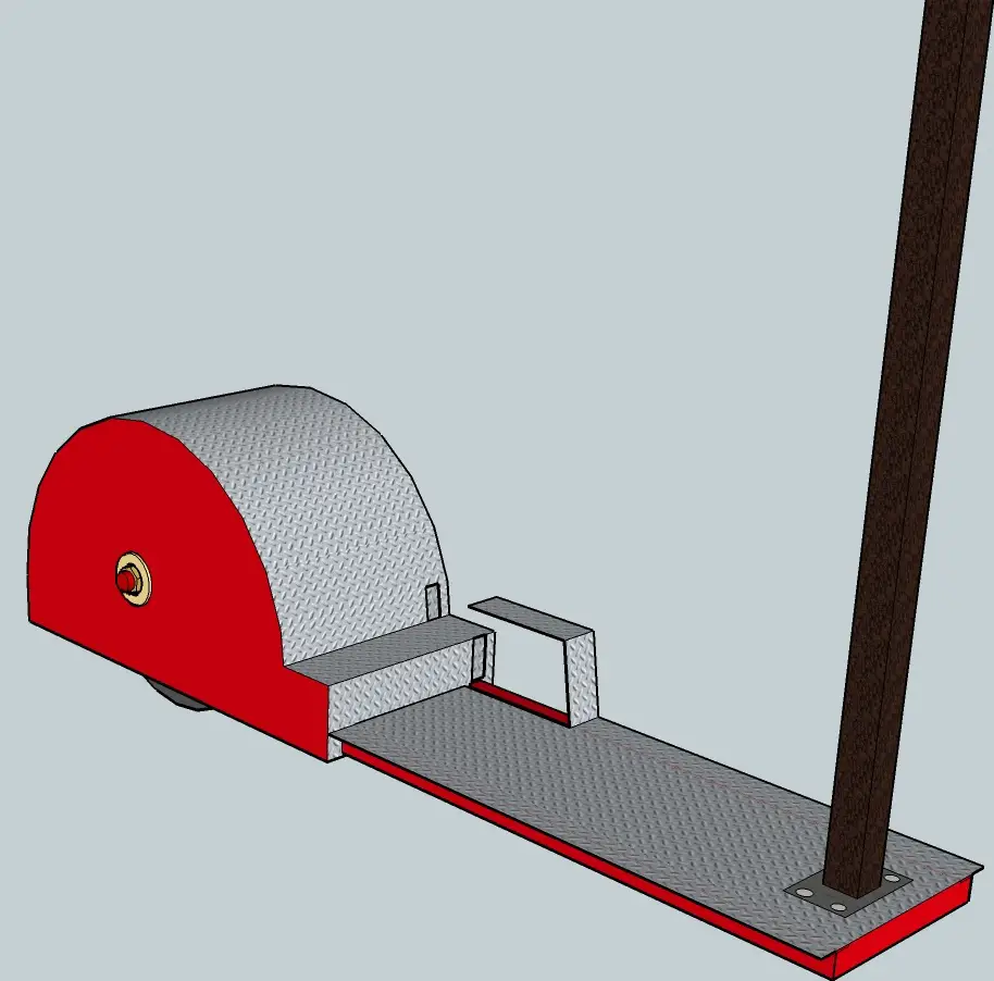

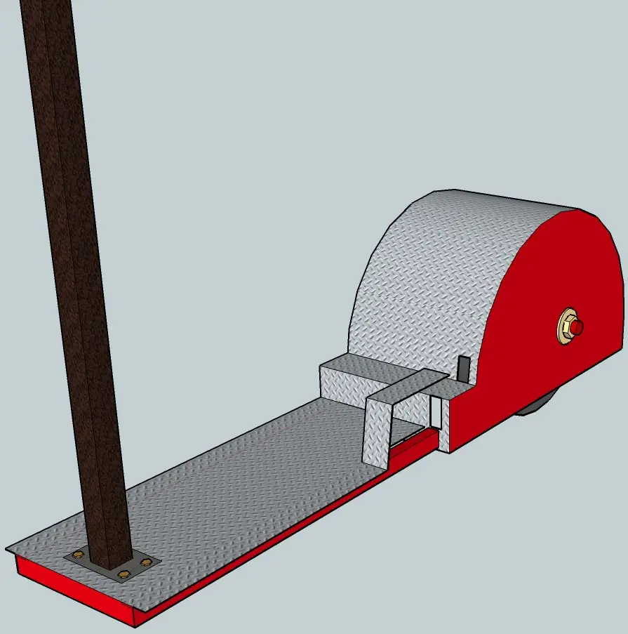

After some riding of that monster I decided to start what I originally purchased it for.
Here are some attachments of what I planed and proceeded to do.

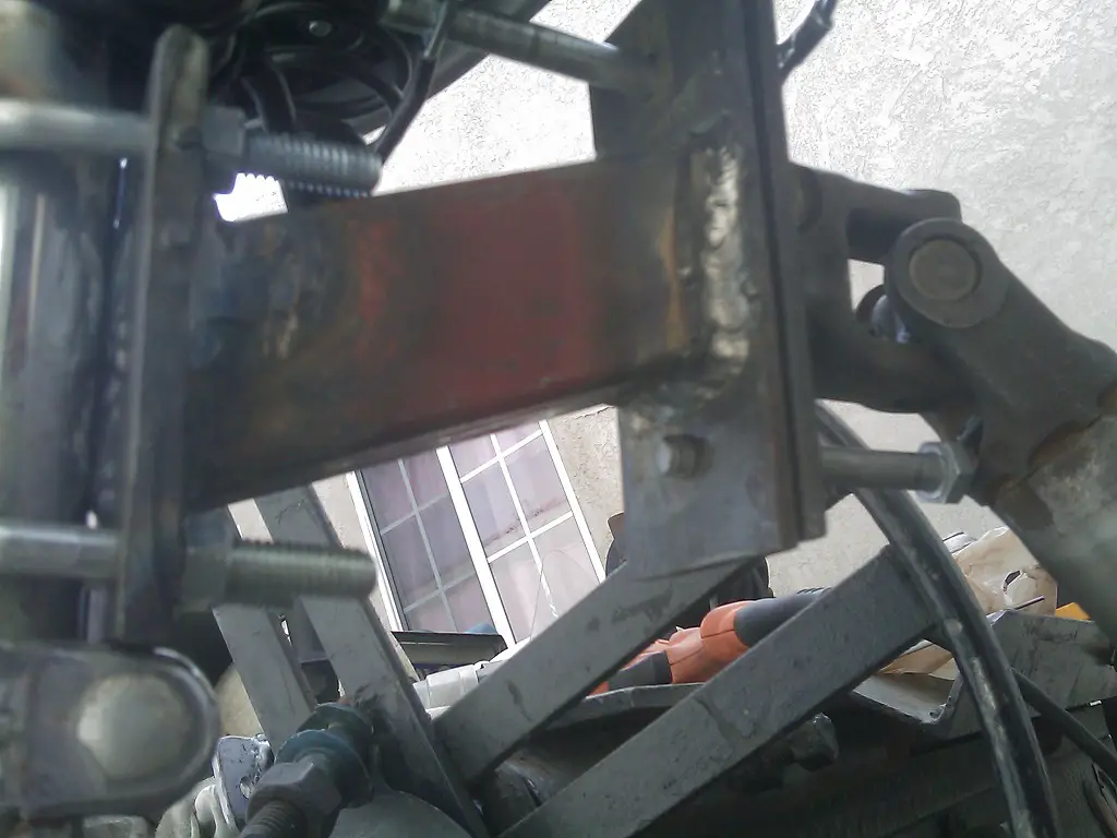

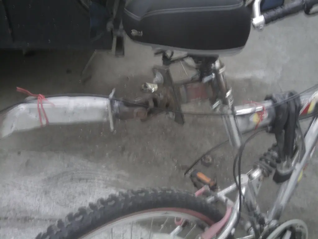

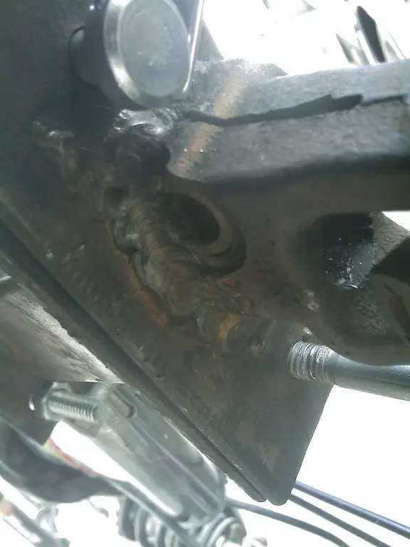

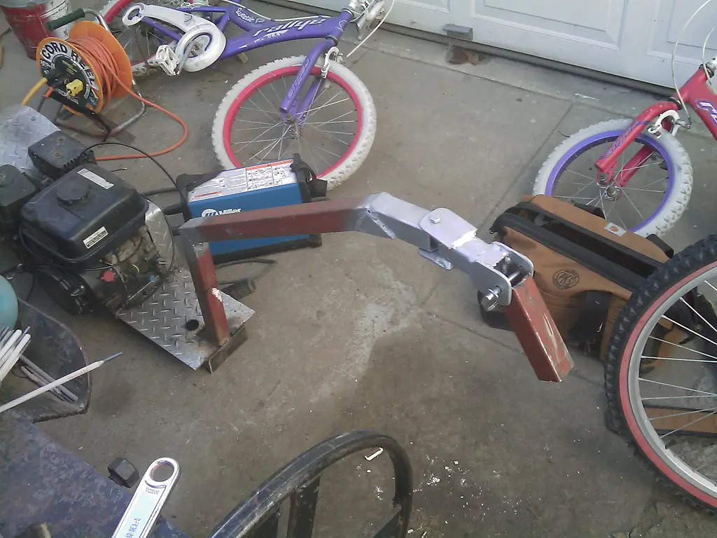

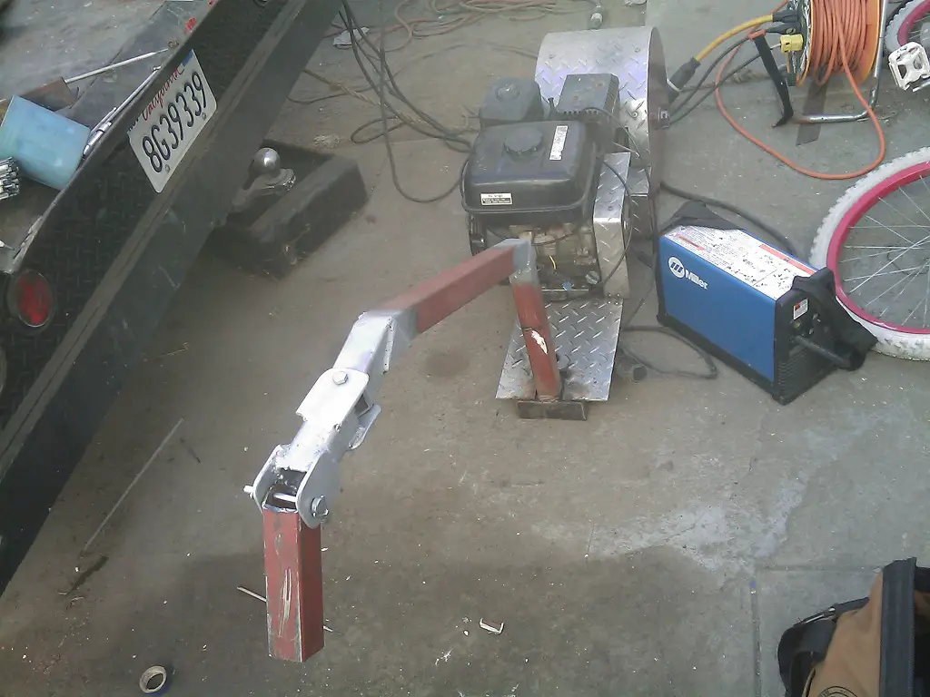

I had a hard time deciding on what I'll use for the hitch. That combined with bad planning and bad welding made a horrible hitch. A test ride had some bad results. Due to all the play (oversized holes) the trailer would violently jerk back and forth after a certain speed. It would also wobble back and forth badly. Hopefully a new hitch will fix this.

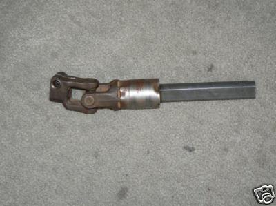

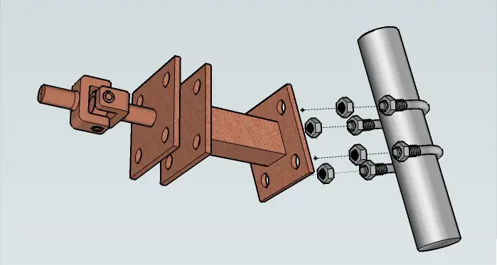

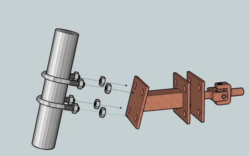

I'm back on the drawing board again with more sketches on my hitch plans. I've already purchased a steering shaft that has a perfect u-joint that I will use. Here are attachments of the shaft and what I plan on doing with it.

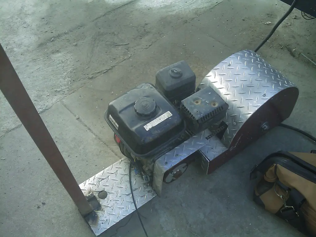

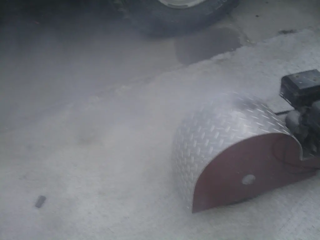

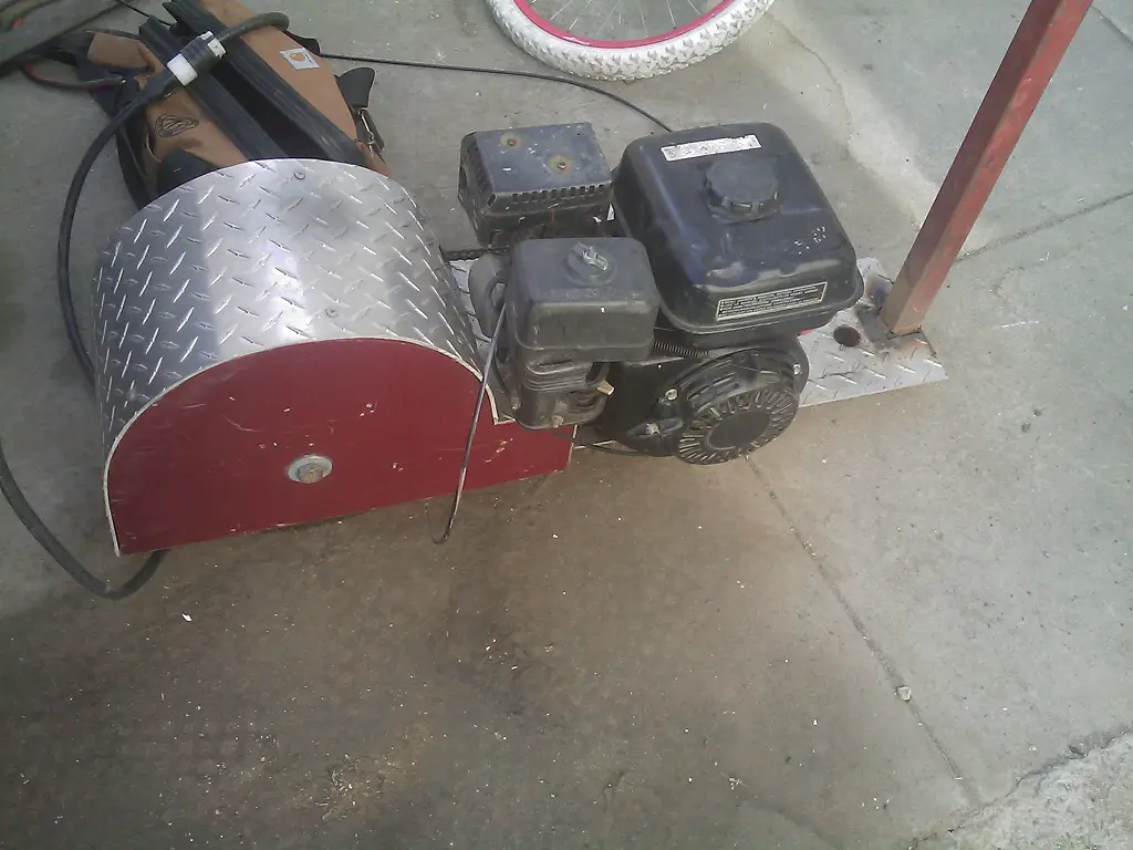

The push trailer is nearly complete. Just need a kill switch. I did find a problem with the engine though. It seems that it throws white smoke after a good drive. Engine most likely *(#$ed up.
I'll probably salvage parts from another 5.5 that I have. Funny that out of all the honda clones that I have, only the real one breaks. The odd thing is that after it starts smoking the rpm rises noticably and smells like it is running extremely. If it is a carb problem, I would be happy. The engine did sit for over a year. Oil is good.
Even though it is smoking the bike pulls very hard and I still haven't hit top speed yet and it keeps accelerating.

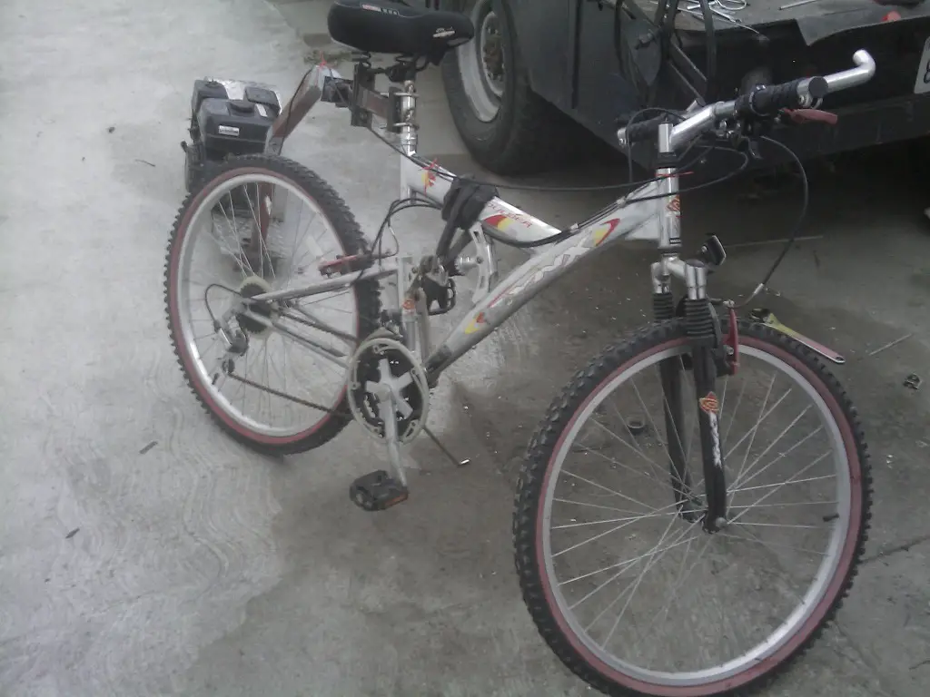

Here are pictures of the new hitch and the smoke from the exhaust.
Off topic: Forget what anyone says about the Miller Maxstar 150 STL welder. I is great only for thicker metal. They have a hotstart feature that helps from sticking. That feature blows holes right through any metal less than 1/4" thick. Most of my time was spent fighting with the machine and repairing holes using my loaded stinger in one hand another rod in my other hand to patch the holes and grind them smooth.
Any work on thin metal requires a wire feed. With a wirefeed machine, your welds are cleaner and Much MUCH more easy.

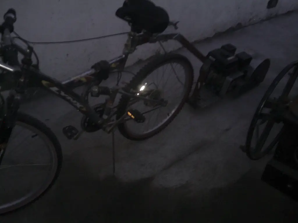

Finally completed. Tested on a 2 block strech and hit 42 mph before shutting down. Hmm. Slightly quicker than I expected as it got there so fast and I didn't top out. Feel like I had a lot more room but I don't think that I'll ever find out. LOL.
