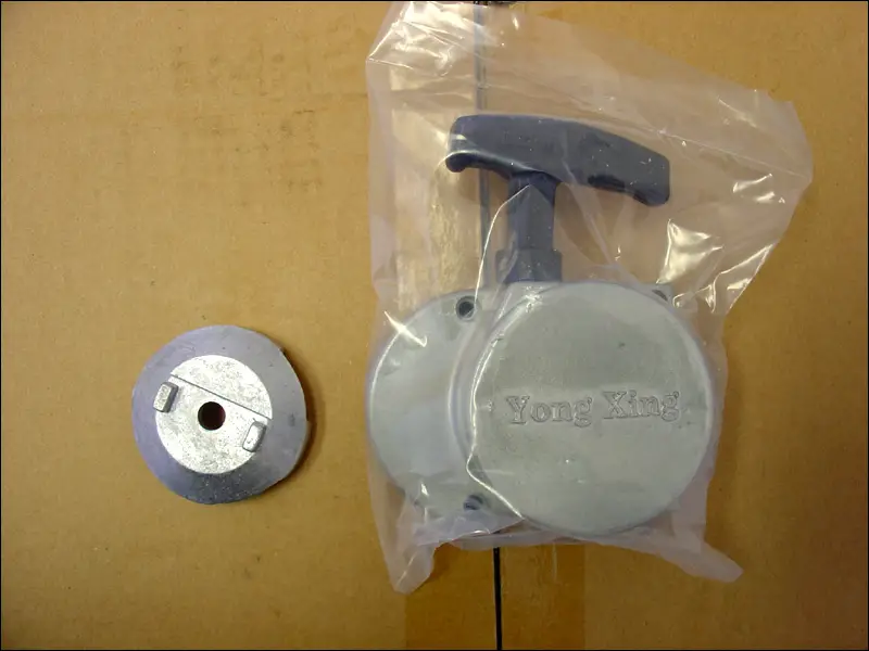

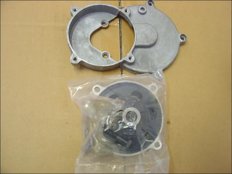

I'm thinking about buying a centrifugal clutch from zoom bicycles. Do I also need to buy a pull start or can I pedal start it? I was thinking that the regular clutch could be used to start the motor and then the centrifugal clutch would take over.
Zoombicycles Motor Bicycle Gas Engine Kits Addon - Centrifugal Clutch (5-3) | 14-Addons (10) | 6-Parts and Accessories | RuiHong Enterprises Ltd.
Zoombicycles Motor Bicycle Gas Engine Kits Addon - Pull Start (5-1) | 14-Addons (10) | 6-Parts and Accessories | RuiHong Enterprises Ltd.

The centi clutch kit from zoom does not require a pull start...you pedal start as normal. I use Zoom's clutch kit on my Tsunami 80 engine, works well after a couple mods that locked the clutch adapter to the crankshaft. I basically keyed it...

I pretty much used a file and a dremel to do the mod MaxPower...I also had to shorten the mounting bolt that was included in the kit, I used my belt sander for that. The mounting bolt included in my kit was bottoming out in the crankshaft hole and would not allow me to tighten things down properly...pay attention to that note if you get one!
I filed about 2/3 of the half moon key so it would be flush with the crankshaft when placed in the keyway and left the remaining 1/3 as is. I dremel'ed a notch in the clutch shaft adapter to fit the part of the key that was not filed. This picture shows the notch I made in the shaft adapter...the adapter is hardened and the dremel bits I used were the diamond coated types...the bits were about 3/32 - 1/8 diameter.
