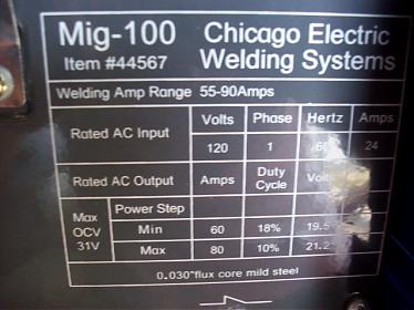

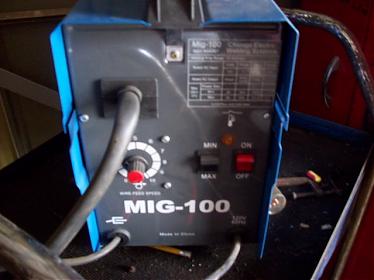

Deacon, I recomend you go with a 110 wire feed. For your need's I think it would work perfect. I've got a 110 that I got at Harbor freght for $120.00. I was a bit worried about the quality of this welder because it is chinese made. But I just needed something for around the house, going back and forth to the shop was getting a bit old.
I have been using this welder for four years now and I use the crap out of it with no problems. I have 4 sure gotten my money out of it. I think wire feed is easier to learn then stick, but it is just like everyhting; it takes practice.
I love to weld, something about making heat and fuseing two pieces of metal into one really turns me on The self satisfaction of making that perfect bead is awesome!

That looks a lot like the machine I have. Mine is Campbell Hausfeld. It works really good. I use it alot. Are you running solid wire or flux core? Mine came with a regulator but as high as co2 is I just use the flux core wire. One thing I have found out too is don't use the really cheap flux wire. I bought some Chicago Electric flux wire and I couldn't hardly weld with it. I switched to some Hobart wire and it was like I had gotten a new machine....................

I use flux for the same reason. And yes the Chicago flux suck's, I used it the first time and that will be the last time.

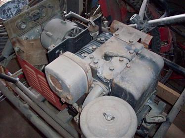

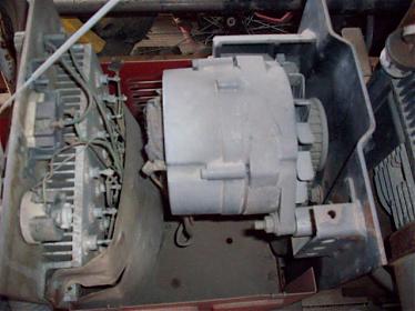

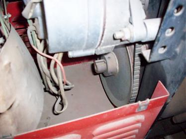

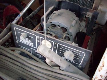

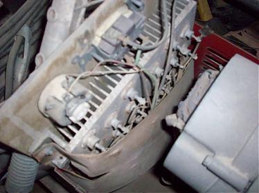

Check this stick welder out. Me and my Dad made it years ago. It used to be a 220 but it burned up. So we used a 400cc Brigg's a Chevy alternator and the control panel and made into a gas powered stick welder. I have done many roll cage's with this guy and it work's great. It is a pain to start with the pull string.
