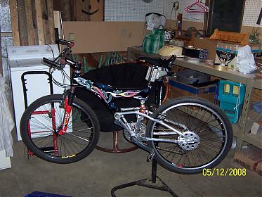

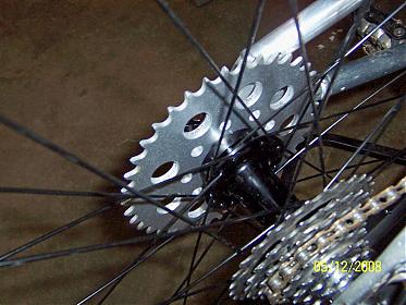

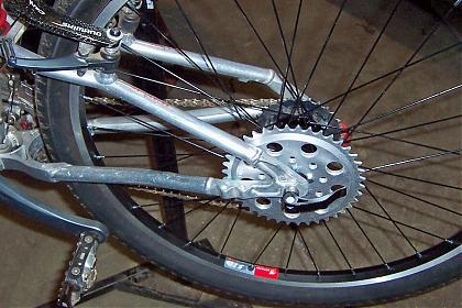

well this is amazing. i bolted the sprocket on in about 2 minutes. i bought a 40 tooth sprocket from kings and it is not only beautiful but mounted nicely. here are some pictures. i am going to get some other sizes and its nice an hour job takes 3 minutes and no more bent spokes. plus you know you are all square. here are some pictures

Lucky dog... I had to grind off my disc brake hub mounts because the sprocket would've hit the frame. I've got a deep-dish rear end with 9-speed cassette, so the offset is pretty far left. In fact, even after grinding off the rotor mounts and spoke-mounting the sprocket in addition to engine left-tilting, there is noticeable "chain-walk" (is that a word?) between the offset engine and spoke sprockets. Only time will test long term durability in my case.
