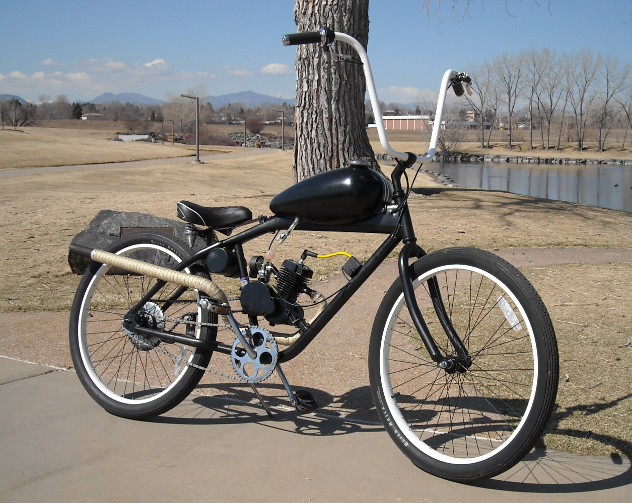

I bought a RAW 50cc. It vibrated a lot and had little power. It died within 150 miles. I beileive that 2 things killed it. An unbalanced crank shaft and air leaking through the poorly designed carberator mounting causing a lean condition. Either one of these things would have killed the engine on it's own.
It seems to me that all of these companies have sold some bad engines and more good ones. It's a gamble and the best you can do is buy one from a company that will warranty the engine and make good on the warranty.
I replaced the engine with a DAX and have had no problems with it but I do not think I will be using Chinese engines on future bikes I plan to build.

WWCherokee sweet exhaust, nice bike.
