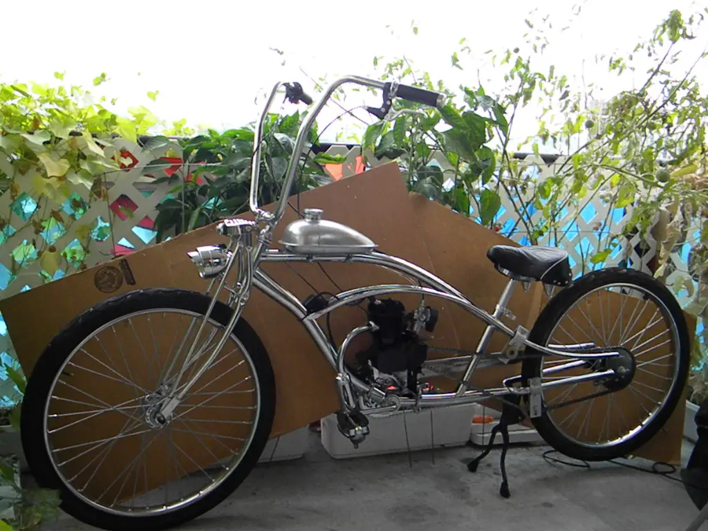

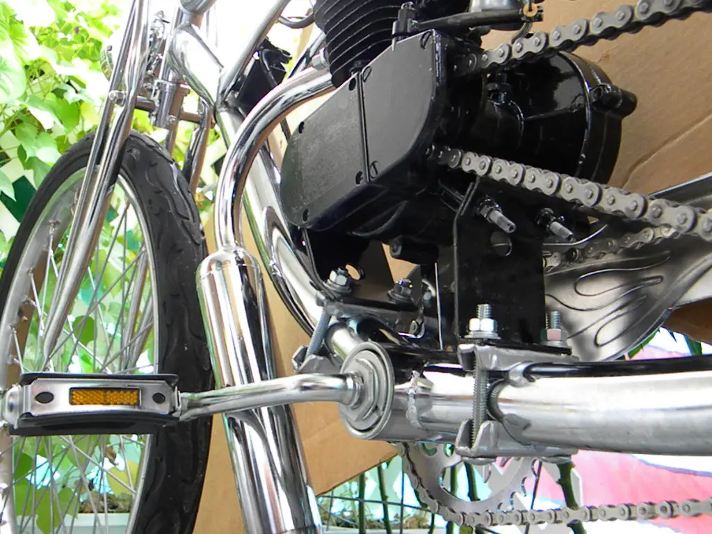

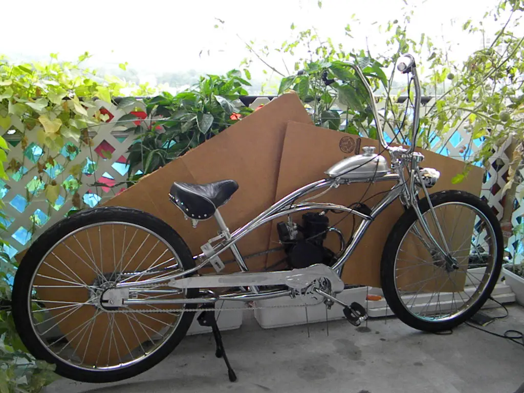

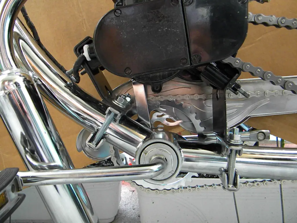

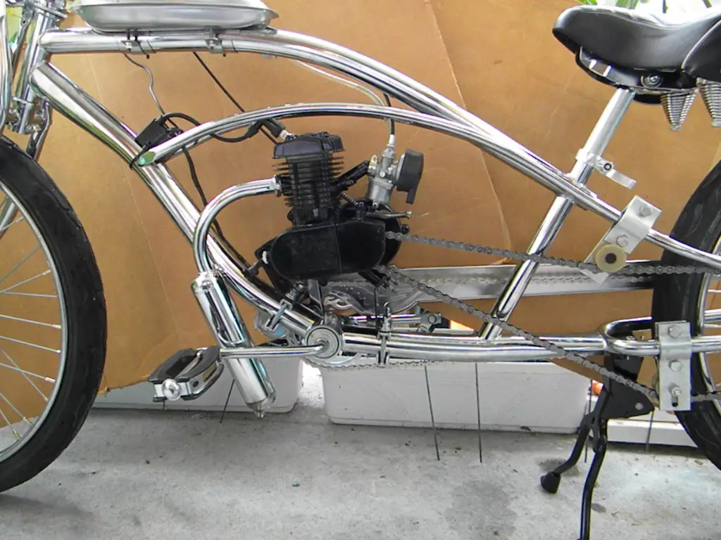

!HOW! Crazy Horse here with another build for a customer ready for delivery, it's a Chrome Stretch Cruiser, with 66cc/80cc motor Springer front forks, Ape Hanger handlebars, and a lil headlight up front!
I'll post some better pic's before this beauty gets delivered, and some closeups of those RedB66 designed A-24 Simpson Strong Ties, custom motor mounts!
Peace Crazy Horse aka Joe!

Hey crazy horse
I am also building a marcagi and i have fabricated the exact same motor mounts that you have.
Does yours tend to flex ? when i put tension on the chain it looks to me like the mounts are flexing a little more than i am comfortable with.
And i noticed you changed your kickstand, i just installed my chain and it is obvious that i will have to go to a differant style.
Is the one on your bike somthing you fabricated ? or is it off of snother bike ?

Joker, I used two simpson A-24 strong ties on the front 1 on the rear if you double them up front and rear you'll have very stiff mount for the engine.
As for the kick stand it's the stock kick stand that came with the bike, you say you are building a Micargi Stretch, this Chrome Stretch that I built was a Greenline Stretch Cruiser, the micargi may be a lil different as for the kick stand, and I did not make any adjustment for the kick stand my chain cleared fine. As for the front chain ring I used the 36-tooth which gives you more room for engine clearance!
Hope this helps.

Location: Conneticut
Posts: 384
Thumbs up Re: Chrome Stretch Cruiser Completed For A Customer
That bike is awsome but... it deserves a better gas tank.

Default Re: Chrome Stretch Cruiser Completed For A Customer
Ok done better gas tank!
This is a Chrome Whizzer gas tank, picture was taken at 2009 East Coast Motorized Bicycle Rally, held September 2009 at Cape Henlopen / Rehobeth Beach Delaware.
Picture was taken on the boardwalk at Rehobeth Beach, Delaware
Peace Crazy Horse.
PS For those that may not know this is a Greenline Stretch Cruiser, almost identical to the American Flyer & Firmstrong Stretch Cruisers!
