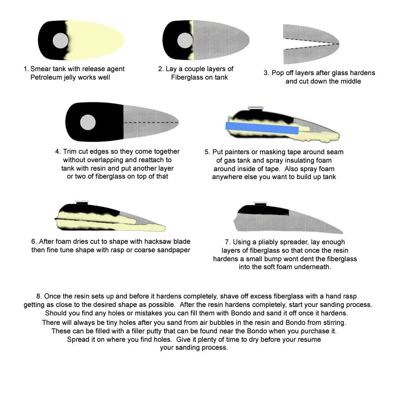

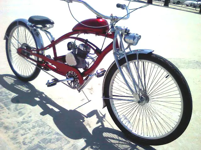

Ive had a couple people show interest in how I customized my stock gas tank on my stretch cruiser. Since a picture is worth a thousand words I drew up a little how to guide and attached it here and another picture of the finished tank.
You will probably need to magnify the picture a little so you can read it. After you click on the attachment, click the little magnifying glass at bottom right of Internet Explorer screen.
Hope it helps anyone interested in trying it.
