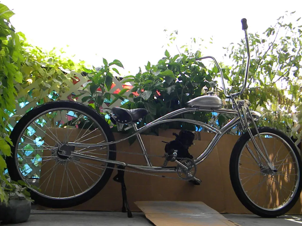

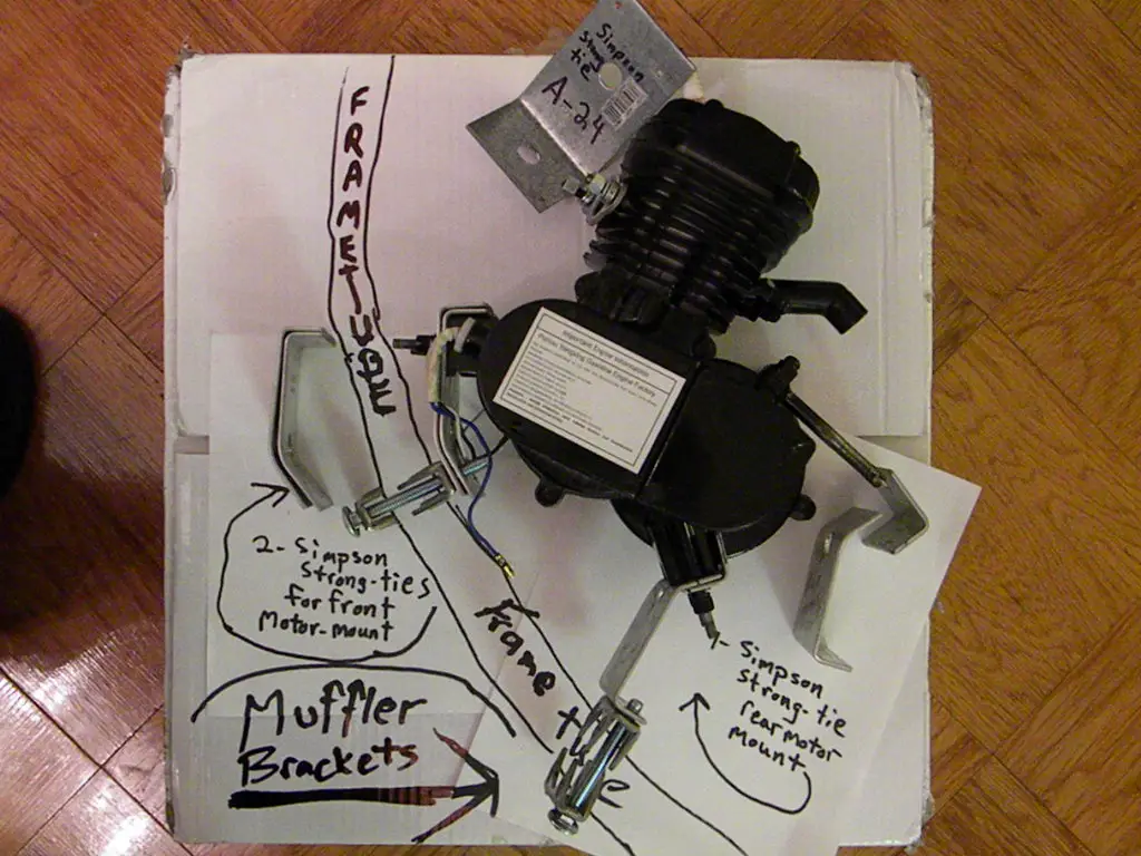

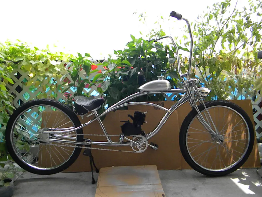

I'm just starting another build as of Saturday July 18, 2009.
This build is a chrome stretch cruiser springer front fork, crank chain ring is chrome with flames, coaster brakes will add calipers brakes later.
I must say the coaster brakes alone are an accident waiting to happen so I insist that my customers add these to their orders!
This build is a RedB66, inspired design, from one of his many amazing builds, the chrome stretch cruiser build!
Motor is the PK Stealth 66cc/80cc from zoombikes, and mounts are fabricated using the RedB66 (forum moderator), design using simpson strong ties # A24 they are super strong 12 gauge steel, then cut & bent in vise to fit in stretch cruiser frame with four (4) muffler clamp brackets & four (4) 3/8"inch bolts, one small piece of A24 used with rear mount to clean up and hide motor semi circle just a cleaner look I think.
Wheels are 26"inch worksman heavy duty 12 gauge spokes and rear drive sprocket is 36 tooth, as I said will add caliper brakes if customer wants, I personally recommend they be added for extra stopping power especially on a motorized bicycle. Ape hanger handlebars, and tires with flame treads, cruiser double sprung comfort seat.
Thank you RedB66, for your inspirational stretch cruiser designs & modification's!
One pic show's RedB66 designed motor mounts using simpson strong tie's & last two (2) pic's show a black stretch cruiser.
Peace Crazy Horse.

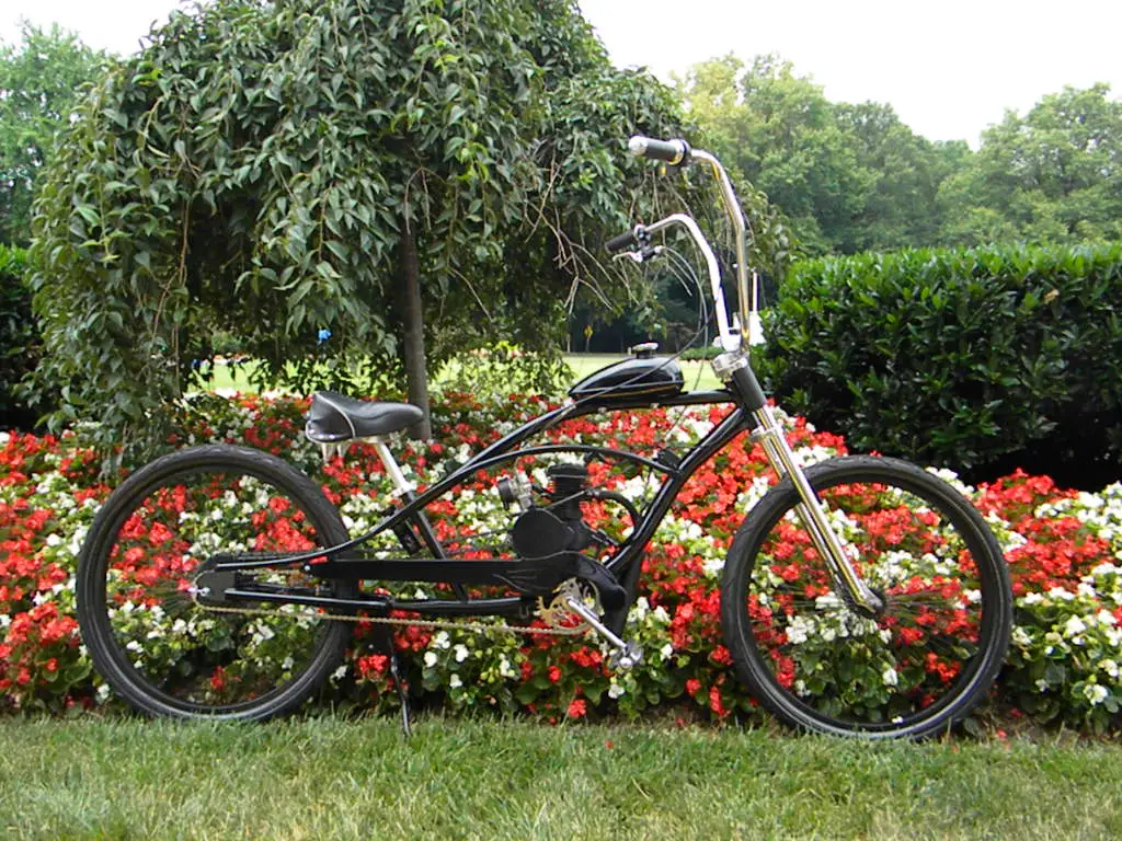

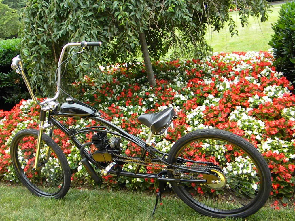

I originally purchased 5 Greenline Stretch Cruisers from Greenline Bicycles 3-Black & 2-Chrome in June 2009, and by strange coincidence all 5 bikes never left me.
Some things are just meant to be, I did motorized 1-Black & 1-Chrome bike with 2-strokes, and now my other three Greenlines are waiting to be motorized with 4-strokes!
Peace Crazy Horse.
