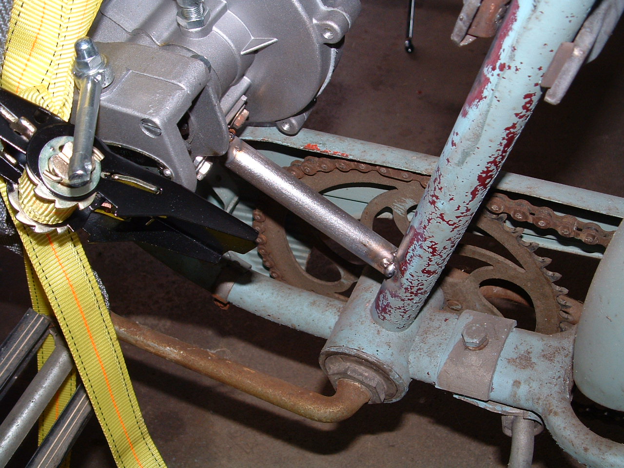

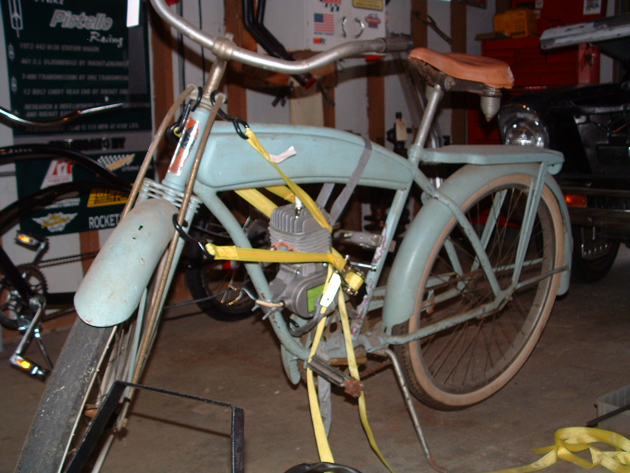

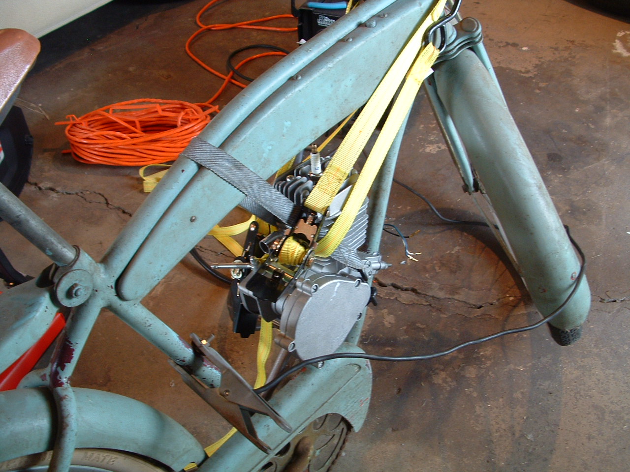

Hey Guys Started Mounting The Motor In My Monark. I Have A Skyhawk Gt-5 And After Some Thought On How To Go About It. I Came Up With A Simple Mount That Should Be Solid. Check Out Pics. These Old Bikes Have Longer Frames Than What Is Available Now So Using The Stock Mounting Points On The Engine Is Out Of The Question. I'am Making A Rear Hub Right Now. Next Will Be The Gas Tank Which Will Be Inside The Stock Tank. Always Welcome Any Ideas Or Suggestions- Big Mike

I try never to criticize anyone's work but I hope that weld in the first photo is just a tack weld. That is a high stress point and needs a good solid weld. It appears that the tube from the seat post to your engine is made from 1/2" EMT, (electrical conduit) That material is galvanized and to get a good joint the galvanize should be ground off. If you know all this I'm sorry I said anything but over the years I've seen some scary stuff and I don't want to see anyone hurt by a defective installation. Please don't be offended I mean this only as constructive criticism.

2door- it is just a tack weld also the steel used was 4130 tube i had laying around I had to sand the scale off before welding maybe that's why it looks like EMT. I have been a toolmaker for 21 years and have some engineering background in internal combustion engines and robotics so when it comes to structual integrity i can sometimes go overboard. But it never hurts to question someone on there way of doing something. no offense taken thanks -big mike
