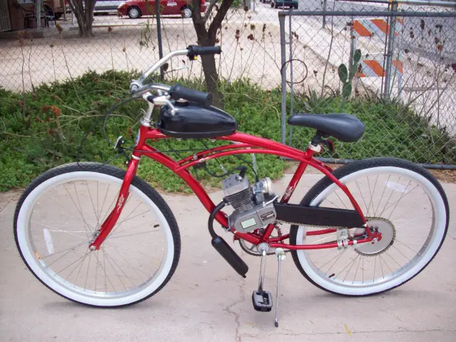

If you use the motors with the bigger front mount the Micargi Pantera is a "Plug-and-Play" Motorized Bicycle.
ID:	10864   Click image for larger version
