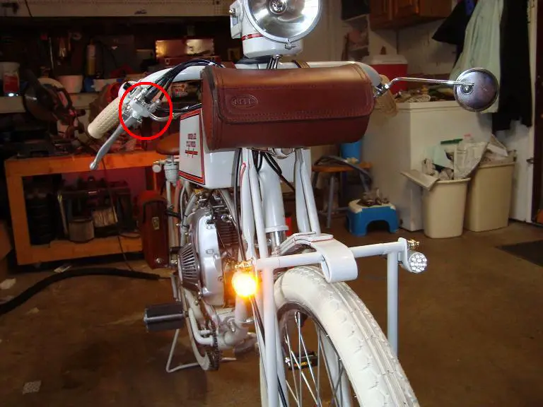

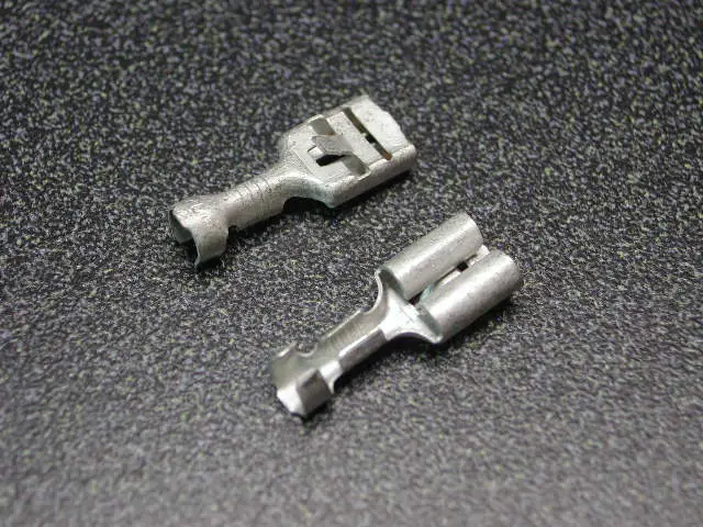

I used those exact switches and I originally sldered the wires....good thing they come in a bag with many.
I ended up using female spade terminals that solder on the wires, but are held onto the pins by tension like those below. Just use the smallest ones you can find. Even those a a tad bigger then they need to be, but mine work well and have not come loose. The advantage is being able to install the switch (screw in) and the pushing on the wires. I used heat shrink tubbing on each spade right up to the end and placed them on the pins so that the flat side of the spade faces to the the middle so they will noy touch each other. It's tough to see in the pic, but maybe you can get the idea.

I put one of those switches inside my brake leaver, its a switch that is reversed, so when you push it is kills the circuit. That way when i apply the brakes even just a tad, the circuit is closed and my brake lights light up.
I use a radio shack iron, does what i need. I let the iron heat up in its stand, tin the wire, and sometimes I may tin the part, if there is plastic that'll melt easy. For those switches, a pair of helping hands is nice, you can clamp the wire and switch down.
