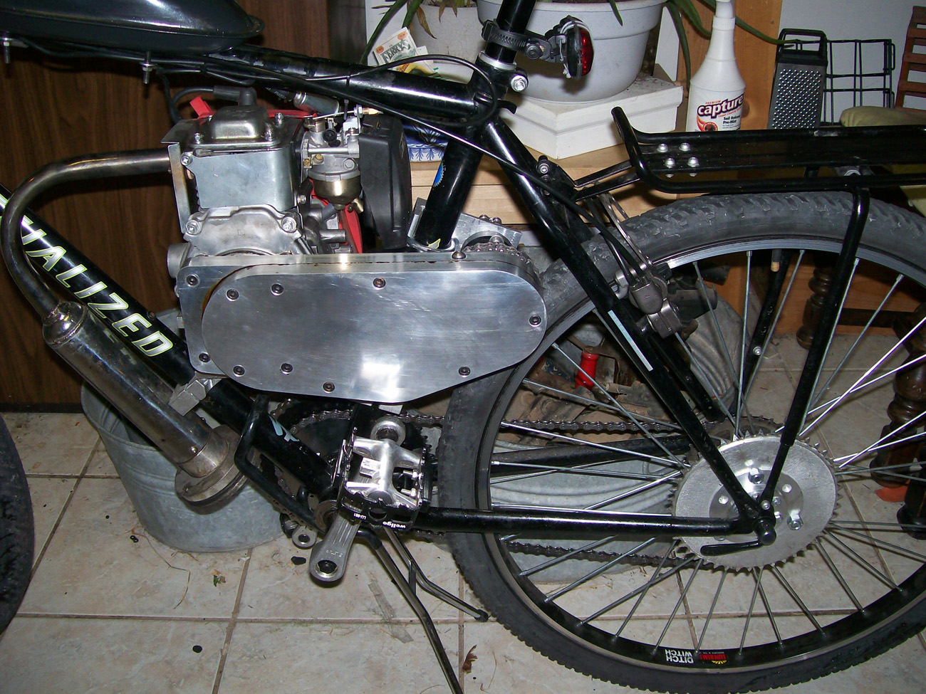

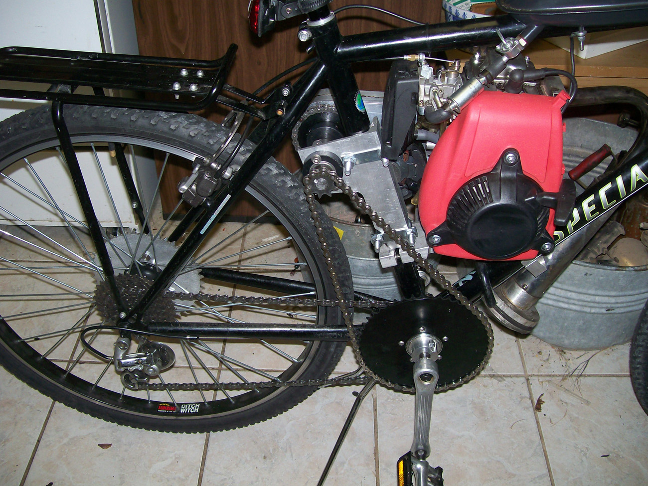

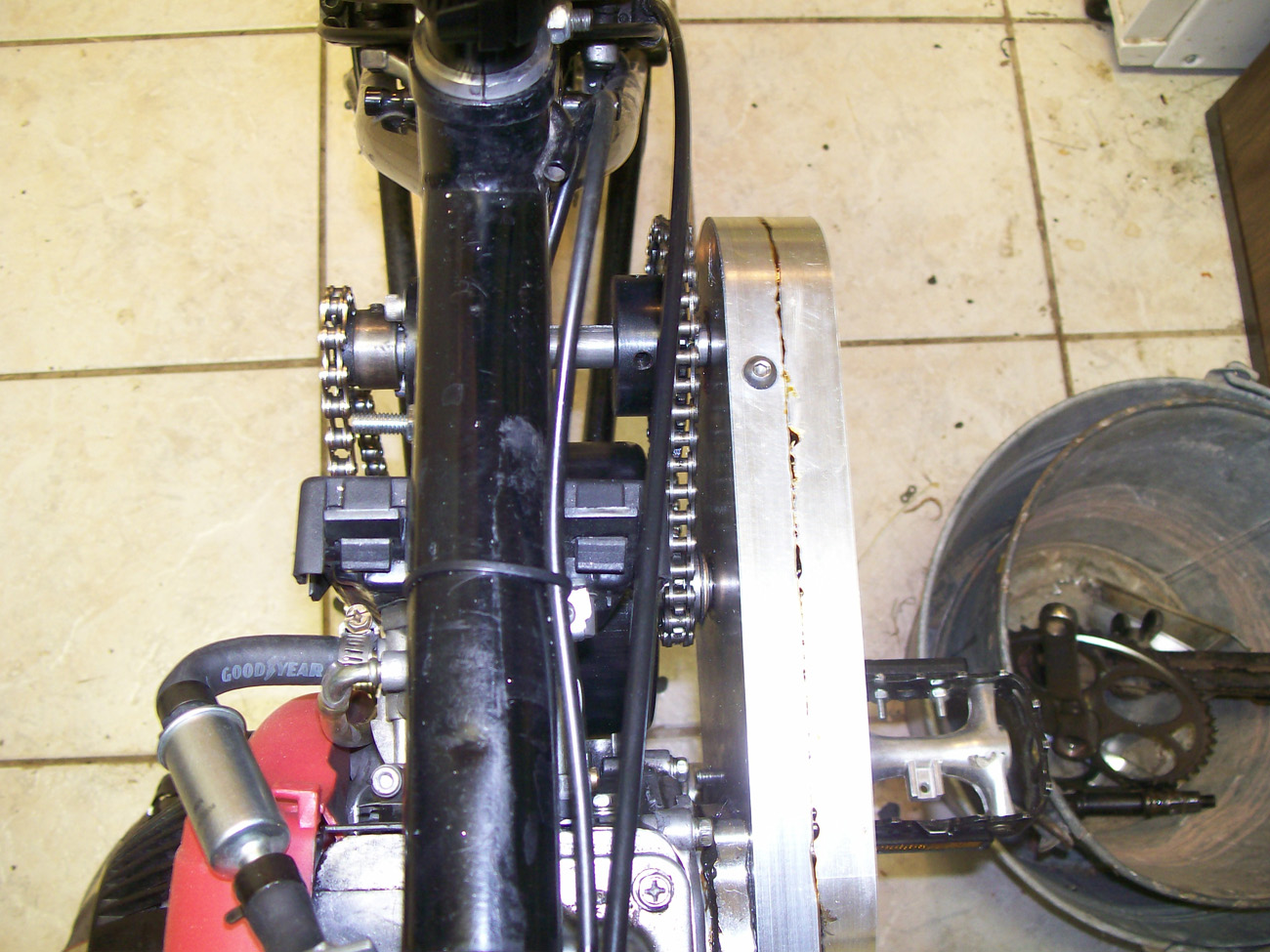

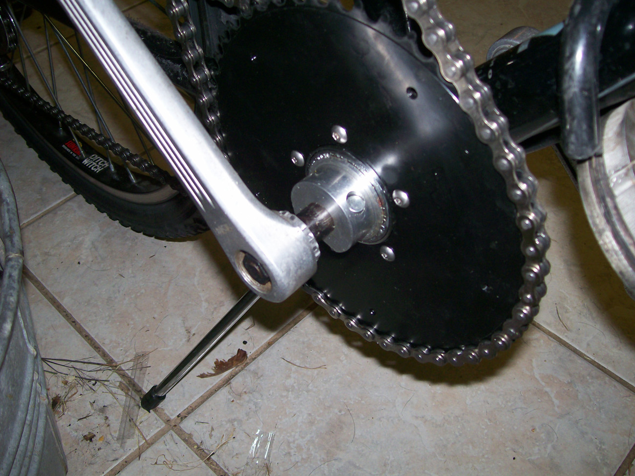

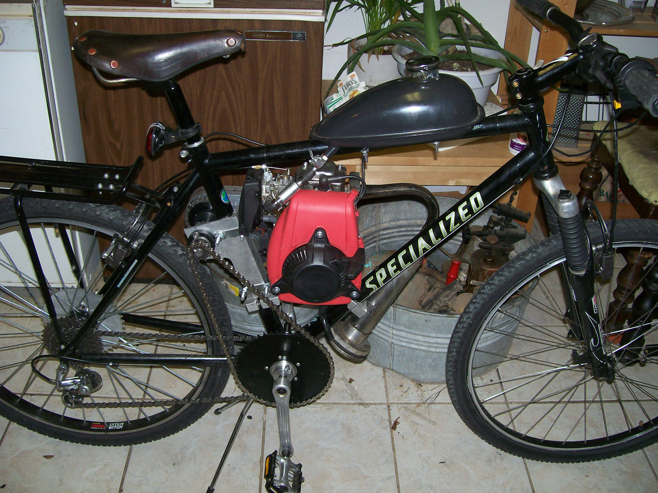

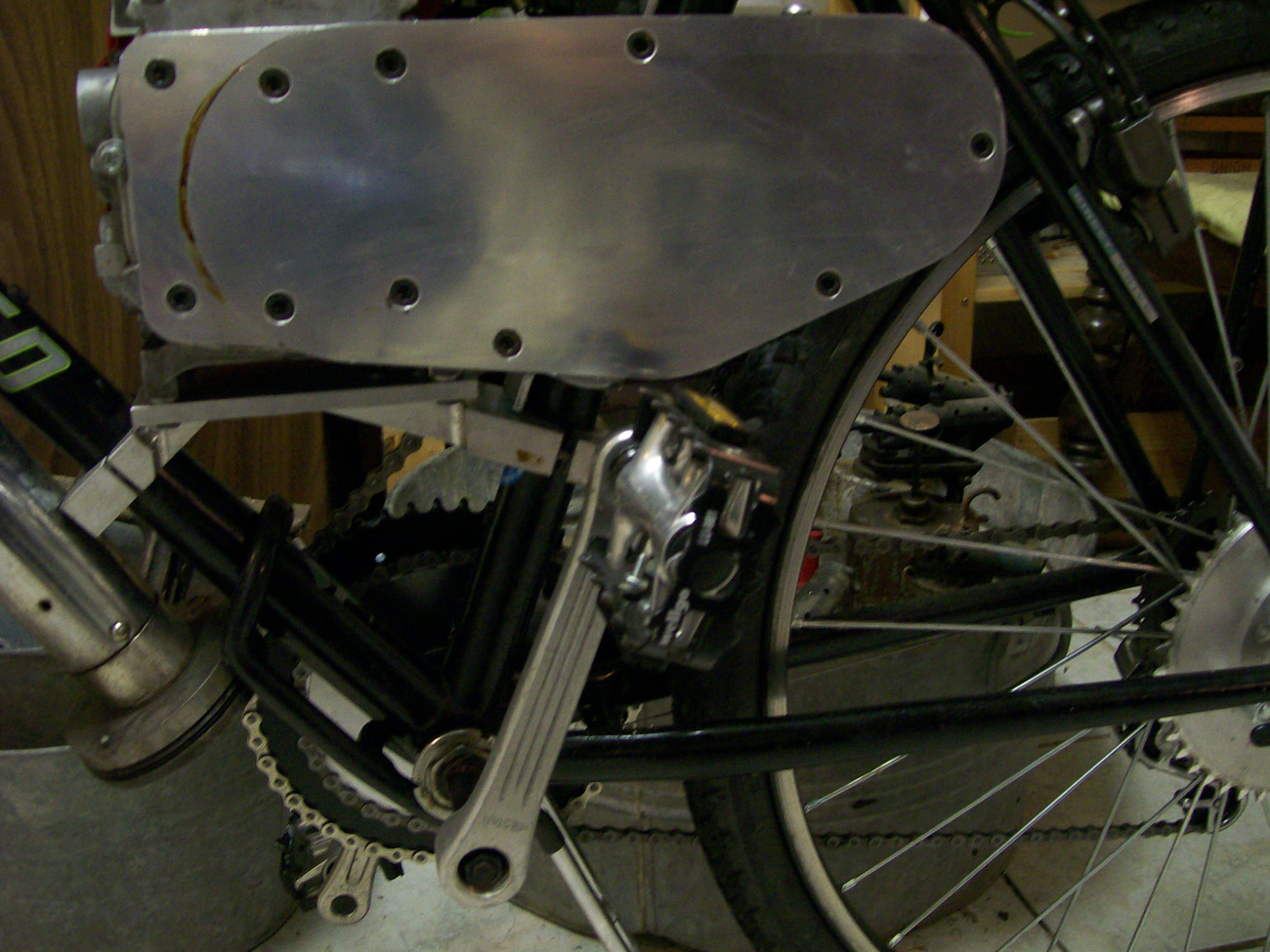

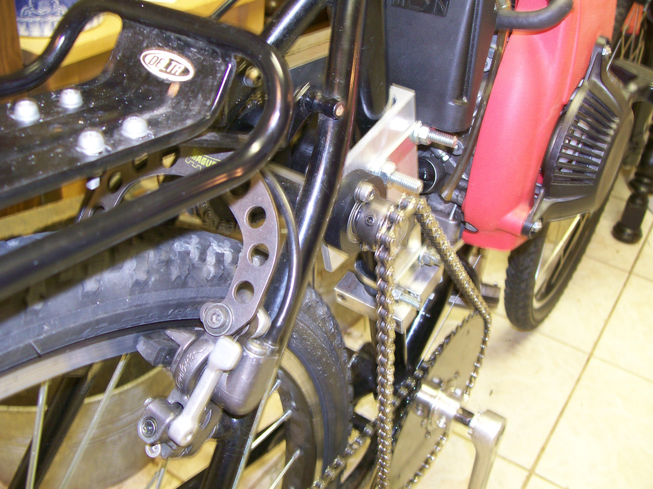

Just took the maiden voyage! ETS around 50 mph! Everything works great just need to respace the chainwheels on the crank as I have a little interference.
I'm excited w/ the versatity; this is what the HardBox trans. was designed to do!
Thanks Jim and Paul for your contributions!

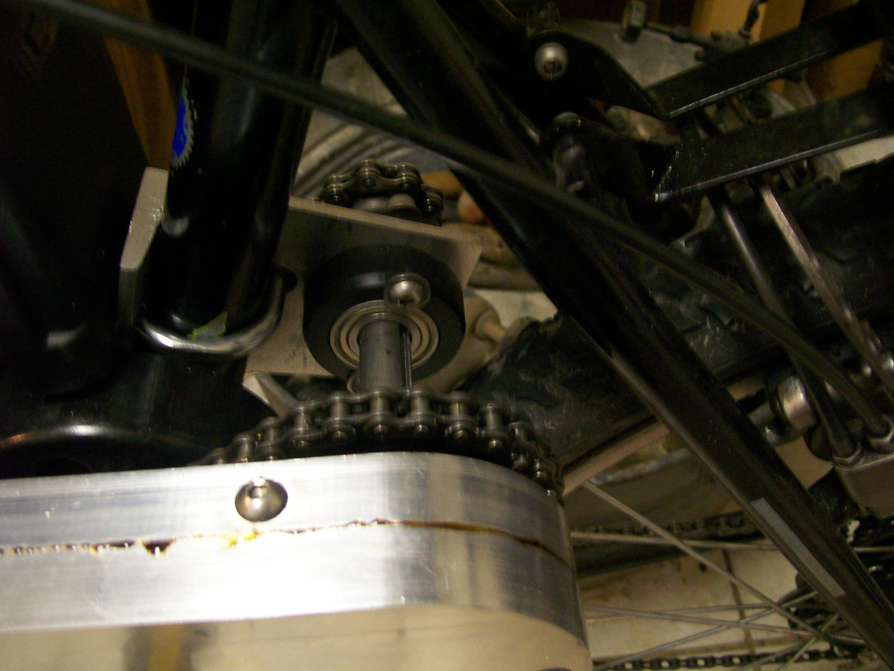

a few more pics

I'm using the HuaSheng but the Honda can be used as well! There are universal mounts in the works. But you could special order a shift kit transmission from me. I've not established a price yet but it will obviously be more expensive than the standard "HardBox" transmission.
In addition to the transmission being geared down it requires a special clutch, outboard bearing carriers, a crank freewheel carrier, freewheel and chainrings.
The crank spindle also requires a little modification.
That said it is a Truly Awesome set up!
Firebelly Cycles's Photos - FireBelly Fotos | Facebook
I'll try to get video and more refined pics up tomorrow!

It is the prototype shift kit of my already available "HardBox" transmission. The universal parts of the shift kit i.e. outboard bearing carrier, better motor mounts, freewheel adapters etc. are in the works. However, I can make up a kit for those who want one before all that universal stuff is done!
So I guess, all of the above! Thanks!
