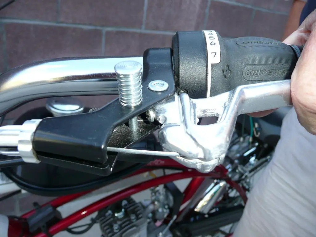

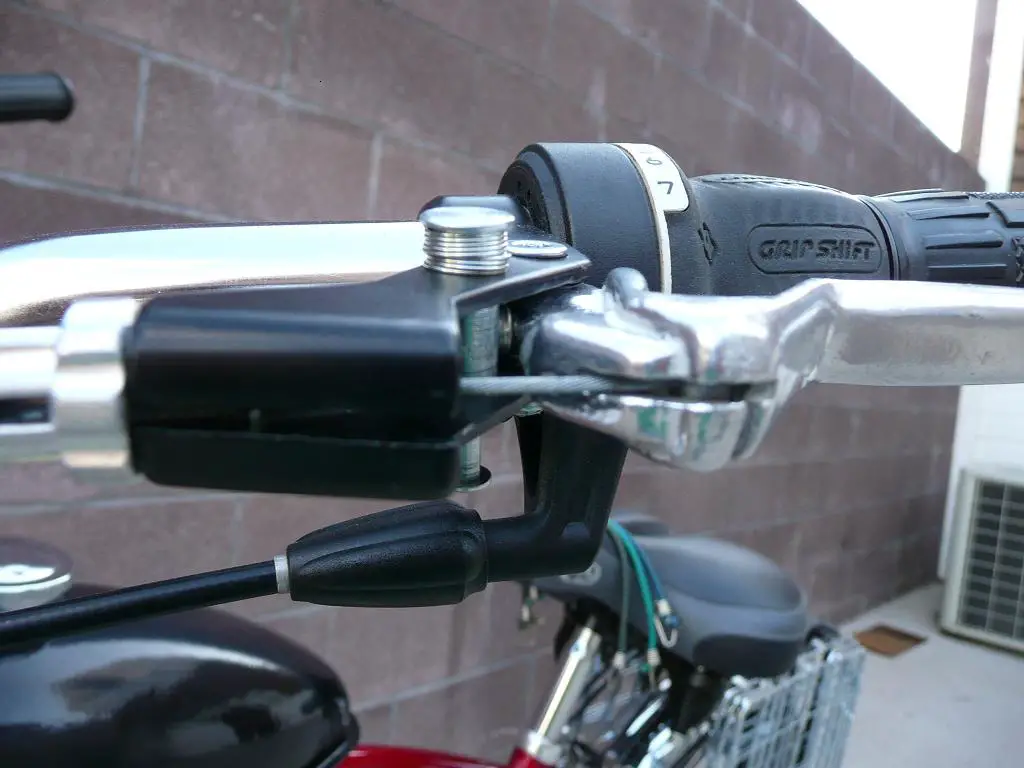

As previously posted. I did this because the lever was defective and would slip from the locked position. Screw carefully placed so it would lock and increase throw. The second pic shows it locked. So far, so good..... But I would first try standard cable/clutch adjustments to remedy.
+1
Did this mod today, worked very well. I was checking out a friends kit and saw his lever was correctly made, mine lacked enough material in the place were it needed the screw. Adds the correct throw and seems to stay put fine. I can stop carrying around a piece of hose.
Marioaz,
If I understand your photo, you drilled and tapped the lever then installed the small screw? Very clever idea and nicely executed. We need more innovation like that from guys building Motorized Bicycles. Keep those good ideas coming. Thanks.
