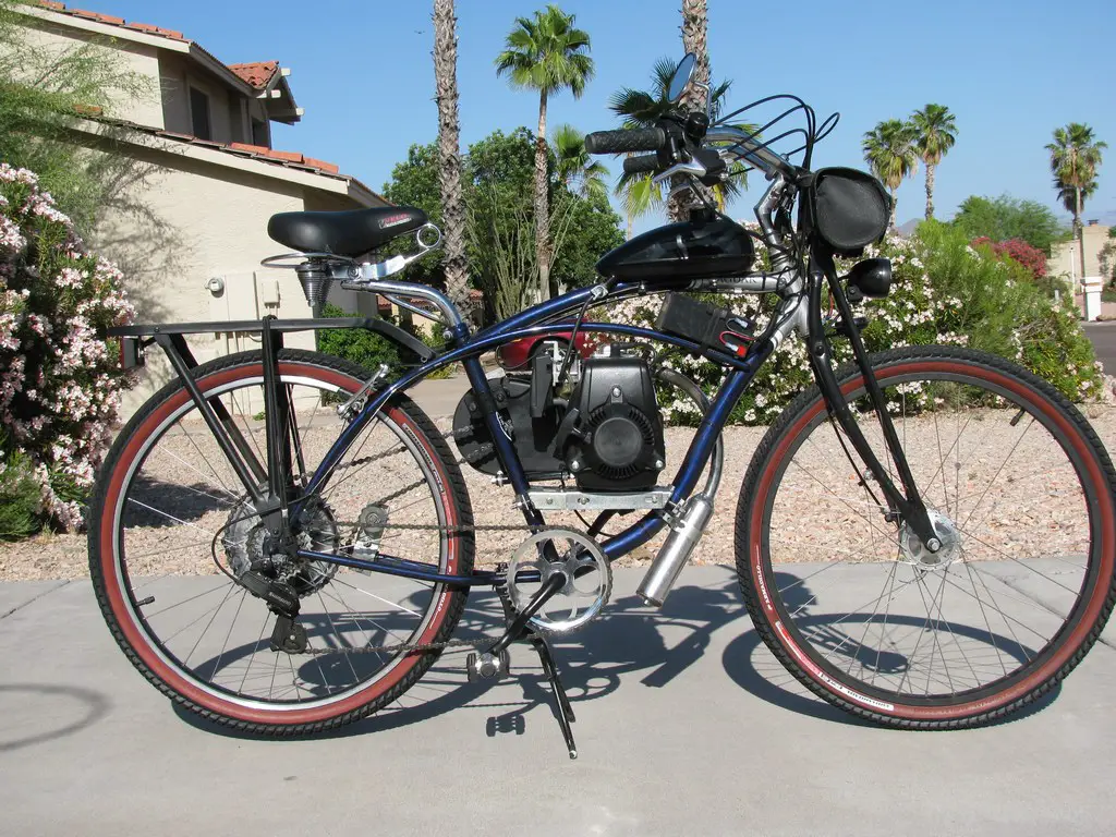

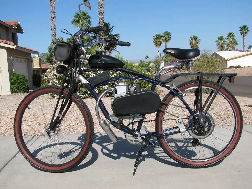

agreed...new Jags are easy to convert to a springer
