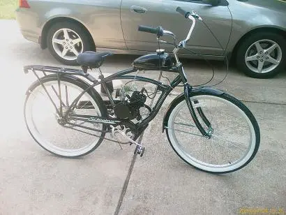

Hello All,
So i have read several post focused on adjusting the idle control screw on the side of my 80cc 2 stroke carb. My idle, (not twisting the throttle while riding the bike, clutch disengaged) is great, however, when i engage my clutch to roll in nuetral (while at a stop) my engine revs really loud. Any ideas? Thanks much. A noobie.
