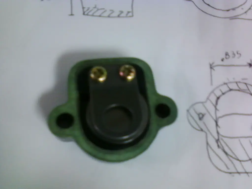

After seeing Sharkcruiser's thread Reed Valve on the cheap, I was inspire to do one myself. So I bought a cheap chainsaw reed valve, 8$ and am going to machine a plate that will go between the reed valve and the engine. It will be one piece and bolt right to everything. Of course, I am going to have ti figure out a new intake as well so this project will take a few weeks.
What you guys think,
Pic of the valve I picked up.

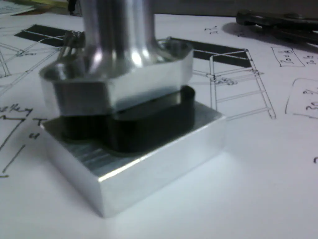

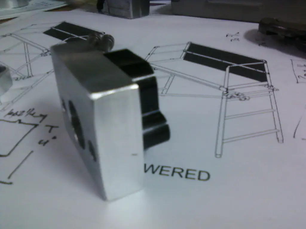

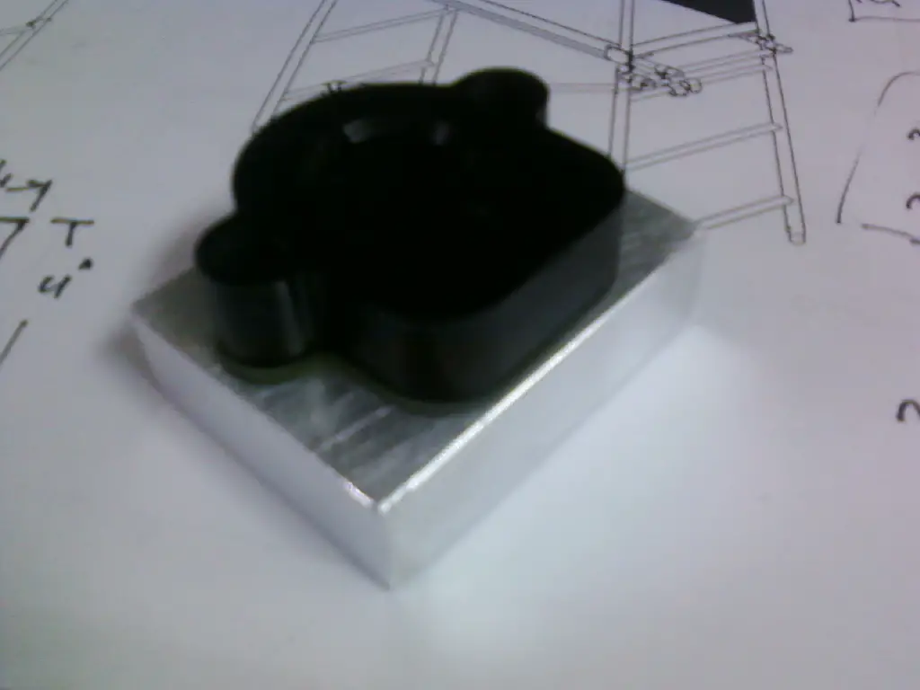

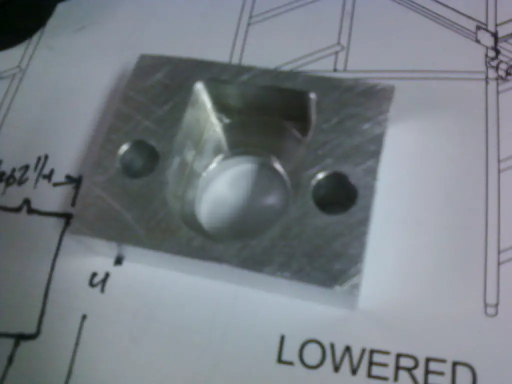

Well, I was finally able to get some free time today at work and machined the bracket. I opened up the side to the engine as big as I could to match the port. I machined the other side to match the reed valve. Then I used a key cutter to open up the inside of the bracket between the 2 surfaces to allow for the maximum air flow. While I was at it I also ported the reed valve hole to just about match the inner diameter of our intakes. The only thing left is to fit it to my bike, and see what customization I have to do with the intake. Im hoping that if I have to do anything, it will only involve moving the air filter. cross your fingers. I will look at this friday and this weekend and get back to you.

that's amazing. great work. you can easily get that to work well w/some tweaking ......in my experience, that round intake hole may be smaller than a nicely ported intake port on the cylinder. On my cylinders, that round hole would restrict air/fuel flow into the motor as the port is way bigger. I may be looking at that wrong, if so my bad.

Ya, the outlet hole I purposely cut bigger than the intake, its actually bigger than the intake port on the engine, I thought it all through. I even ported the reed valve to match the intake ID. I wanted to do this right. The only thing restricting the air is the reed valve, it forces the air to take an almost 90 turn to go through it. But, from my experience, with the reed valve to keep the air in the cylinder, you see more improvement than with unrestricted flow. Because w/o the valve, the cylinder causes the air to pulse out. The valve prevents the pulse. Ill keep you all posted as to how it goes. Will hopefully install this weekend
