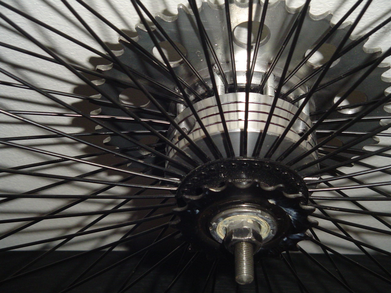

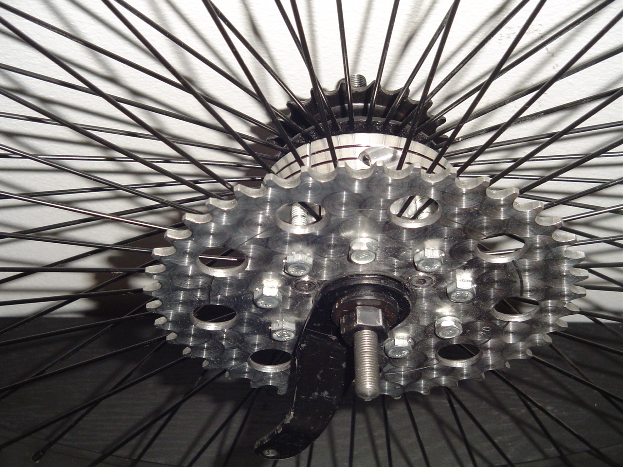

I have a 72 spoked rear wheel. Is there a technique to get the rear sprocket installed, on this wheel, as we all know that the spokes block the sprocket holes. Thanks.
It's possible to do, but it's not worth the hassel. I made my own Aluminum sprocket adaptor but it was a real pain in the a** and I still had to bend a few spokes to make it work. I would suggest a standard 36 spoke wheel and save yourself all the head ache's.
John
