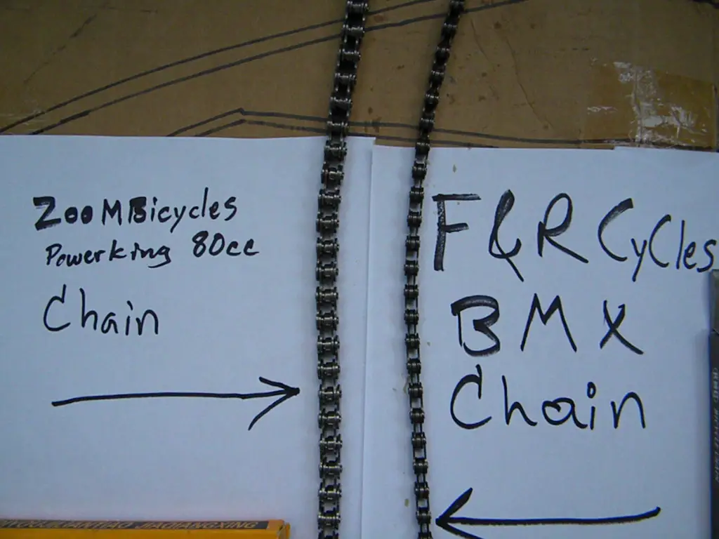

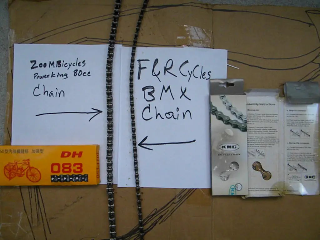

!HOW! Crazy Horse wants to know what is everyones opinion on the safest strongest chain for the zoombicycles powerking black stealth 66cc/80cc.
This is my first 80cc motor the kit came with a DH-083 (50 XINGQIYOUJILIANTIO JIAQIANGXING) chain.
The kit chain is a chinese size 50 1/2 Inch! I might be mistaken on that.
The BMX chain from F&R is a size........ what? Was supposed to be BMX 415 Chain.
I'm putting this motor on a greenline stretch cruiser for a customer & I know I should have known better the kit chain is to short.
I ordered 3 chains BMX from F&R Cycles and the will not fit.
Any suggestions on chains that are safest that will best fit this motor are appreciated. Thanks.
Should I use a #41 or 415 or what do you mb'ers suggest?
BTW Crazy Horse say Many Thanks To RedB66 for Motor Mount Design They're Super Strong!!!
NOTICE: Must See ( wheel rims thread more info 68 spoke ) Crazy Horse no shoot bow & arrows now suffers from 68 spoke-finger-itis
Peace Crazy Horse.
PS am I just another crazy injun or am I blind whats wrong with these 2 chains can you see what I see?

I have always used the stock chains,and so far have had no problems.In fact my first build had over 2500 miles on the original stock chain.But many people do use the #41 chain.I know that didnt help,but that has been my experience so far after 10 total builds.David usflg
that bmx chain looks like 1/8" which is for multispeed bikes like mountain bikes and other bikes 10-21 speed or small kid bmx bikes,also could be for a special bmx bike.
1-3 speed bikes like cruiser bikes and adult bmx bikes come with 415 chain which is 3/8" and is also the main size these kits usually come with,a few come with the thinner 1/8" regualr bike chain thou.
i use the 415 and the 415 chain will work fine but you can use the 41 if you want to.
I would definitly use #41 chain. The side plates are smaller than the kit chain, but it is still 1/2" chain and alot stronger according to the tensil strength charts. The #41 chain, master links and off set links are alot easier to find than the original kit chain. TSC and Northern both stock it. Comes in a 10 Ft. length for about $12.

Looks like you have the typical junk 415 HD chinese chain. It's crap, look at how the roller bushings aren't even wide enough? It stetches like a piece of hot cheeze, unevenly I might add. It will crunch and snap under pedal power. I replace mine with a quality chain and it was worth it! Cost about 15.00 USD shipped and it was made by KMC. From what I've read, the 4 in the number means 1/2 inch pitch the rest has to do with the width. Made sure you get a 415 HD chain from what I see in your pictures.
Shouldn't crunch and snap unless you have an alignment issue,, at least my chinese chains don't,,they all run good and smooth if extra time is spent to sight in the sprockets.
No. Stock will work fine with #41.

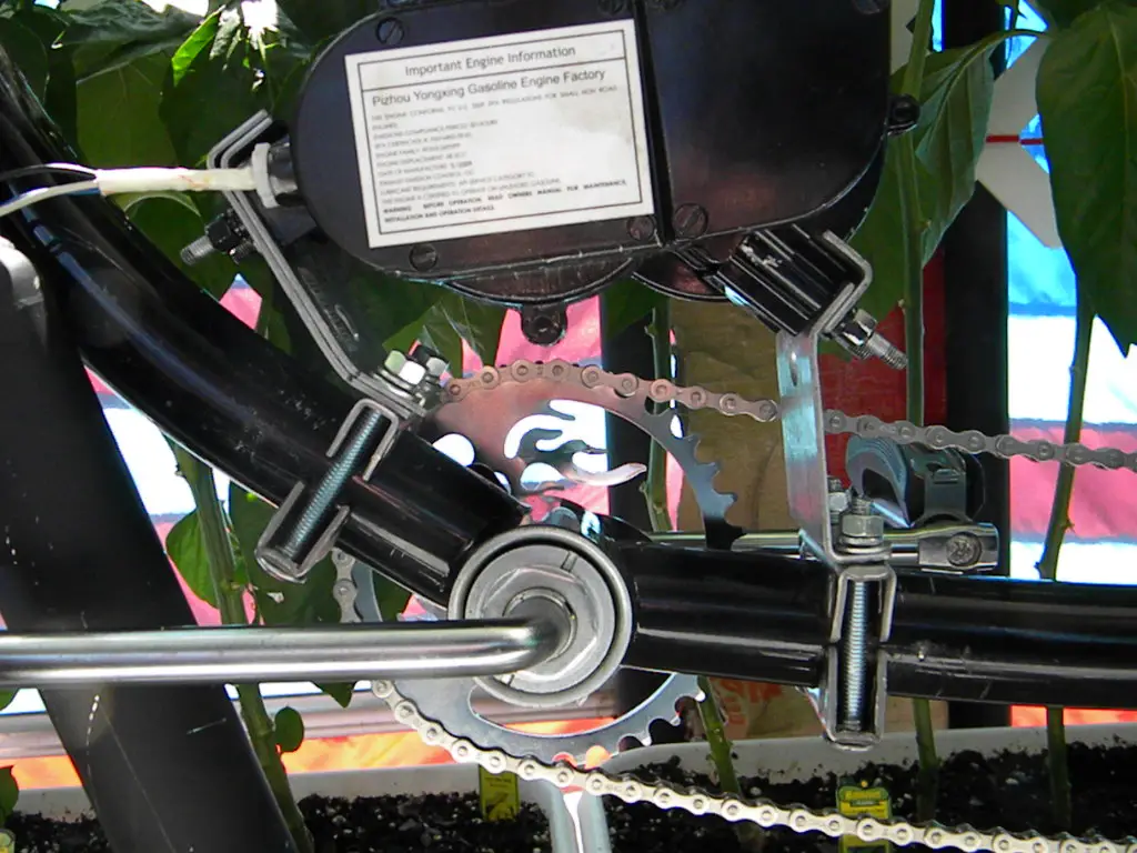

You will need to grind on the front sprocket cover a bit but it's easy.
Search "chain clearance mods" for lots of threads

Industrial #41 is plenty strong enough for any bike I can imagine wanting to ride and I get a 10' box of cheap chinese quality (Still quite strong, just sloppy compared to good stuff) for around $20 at my local hardware store.
It works great with some clearance grinding under the sprocket cover. Be aware it does have noticeably more drag when pedaling on a regular chinadoll build, but it's nothing objectionable and a small price for the strength and service life upgrade.
A good diamond or similar quality will be more costly, but well worth it for durability.
Easy to find at any industrial supply like Grainger
I'm running a BMX chain. It's a wippermann 1R8 1/8 x 1/2. It is nickel coated with reinforced plates. It has a breaking load of 12,500 Newton. It is a good strong chain and it won't twist and it runs through my engine sprocket smoothly with much less drag than the 415, however, the one I got will probably be too short for you.
