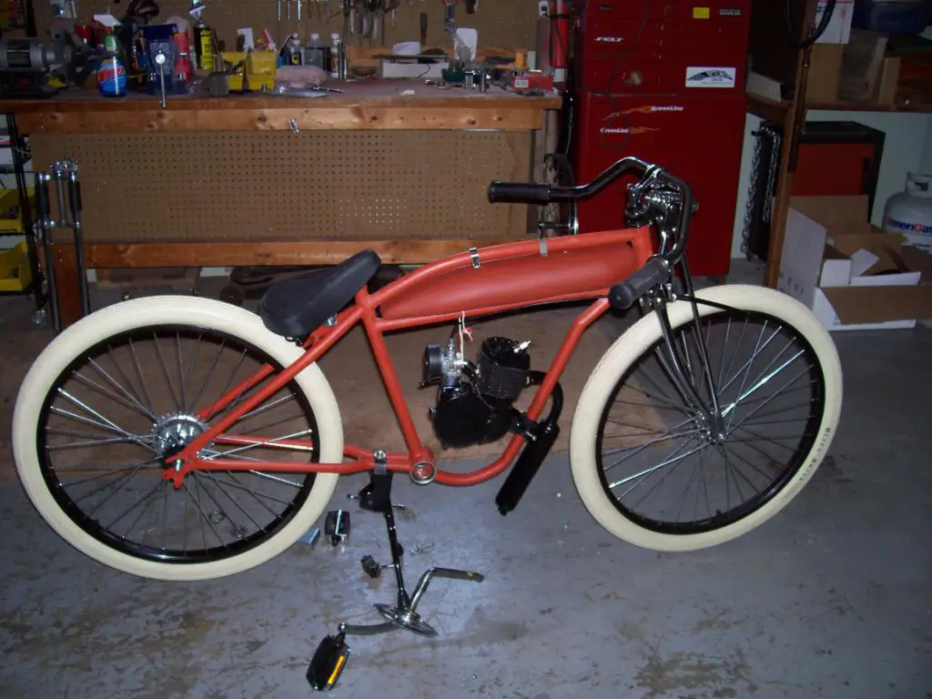

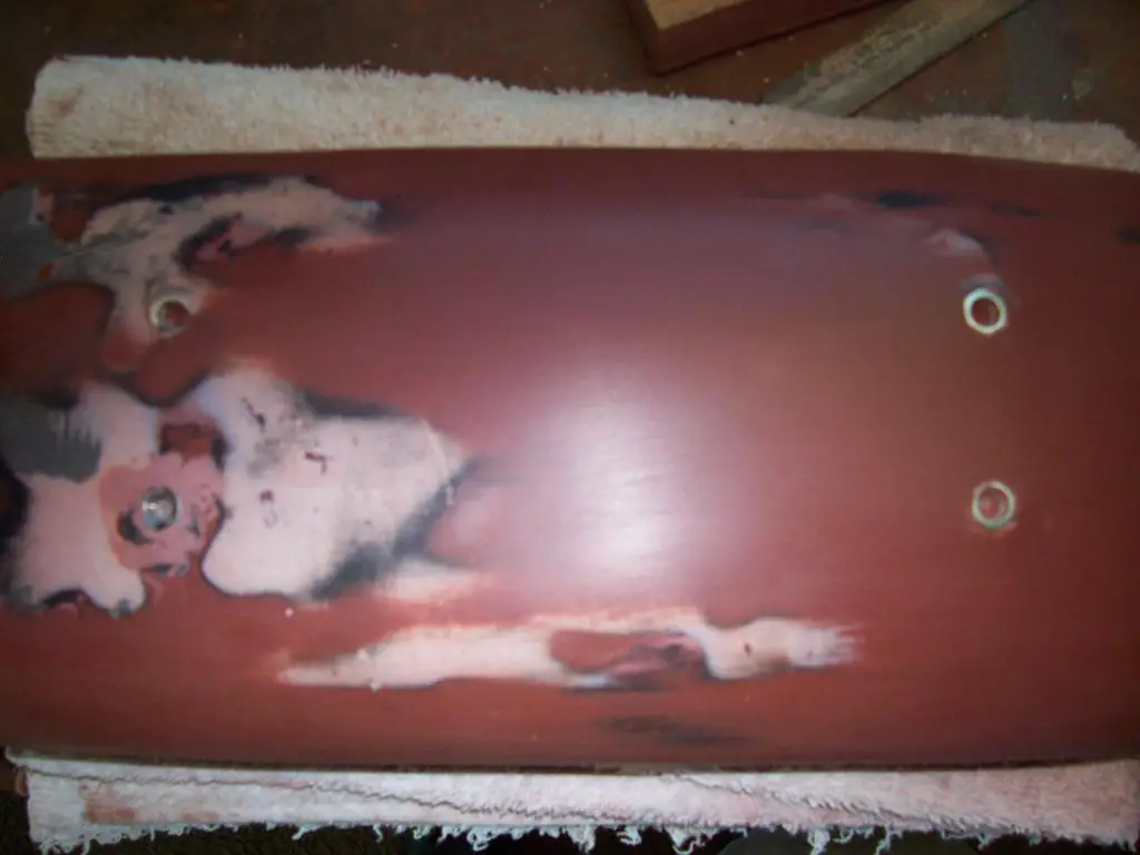

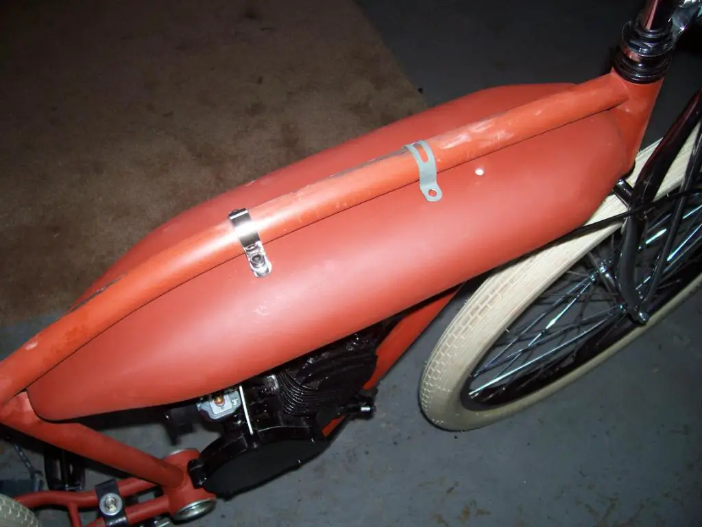

After 30 days of thinking I was scammed. My frame and tank showed up. The tank was supposed to be a complete tank ie: filler neck, petcock and mounting bungs....not there!!
I added some bolts to the top of the tank and fiberglassed them flush. I added a petcock to the bottom the same way. Filler neck is in the mail!!
The loop on the frame needs to be wider. I've gone down to a 25T chain ring to get the motor lower.
