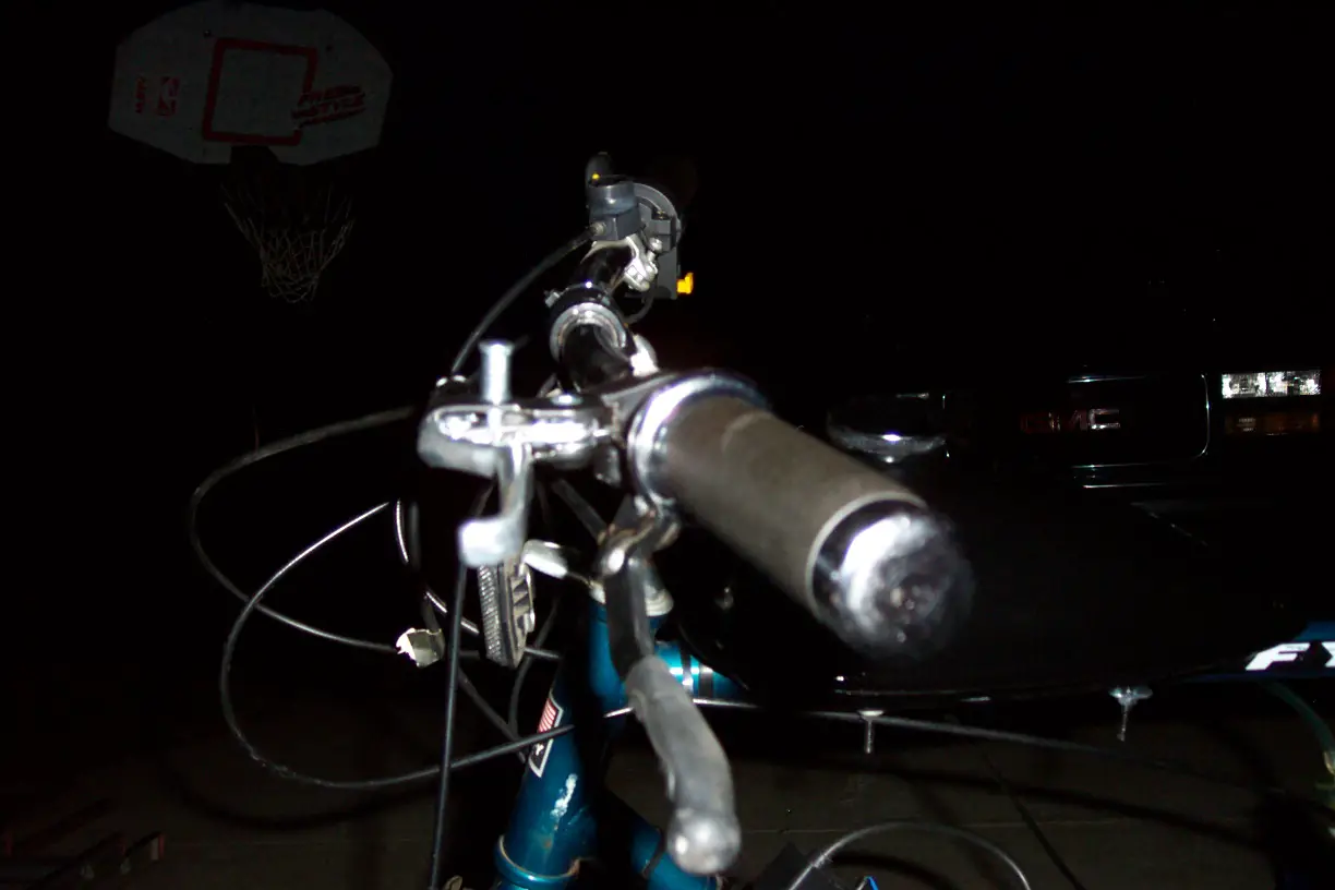

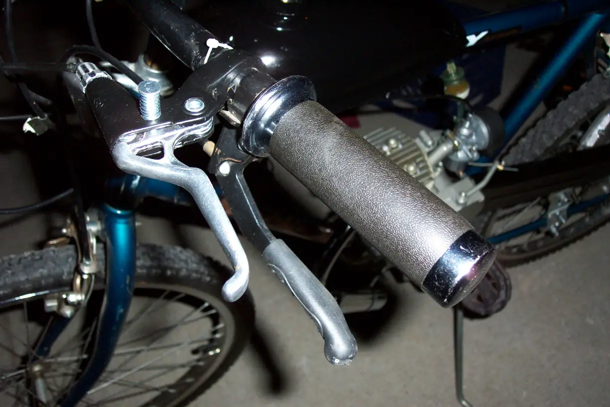

My hand levers need to be moved (See attached photo). My rear brake lever is on the left side along with my clutch lever. The clutch lever is pointing directly frontward. My rear brake lever is positioned below the clutch. The cluth is fine but the brake is difficult to get to. I think I will move it to the right side and put the front brake on the left since it is used much less.

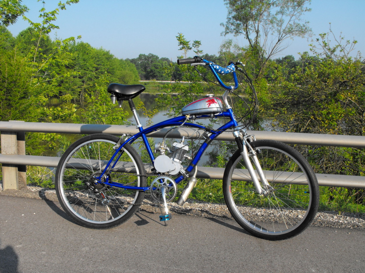

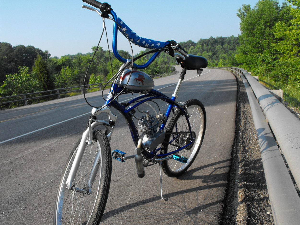

Yes- there are things you can do- I've done some, but not all yet- and it gets better all the time-
I just posted some thumbnails on the "My second build" thread of my bike-
Firstly, when I built it I put on a suspension seat post, BESIDES the sprung cruiser saddle- I got a steel one, 1 inch cruiser diameter,less than $20 shipped on ebay- search "bicycle suspension seat post" there, and "bicycle suspension fork".
Check your diameters (25.4 mm equals 1 inch, 7/8" is 2.22 mm) I saw an alloy suspension seat pillar, with the built in clamp on top, a couple weeks back in a bike shop for $30. The suspension fork I got was about $60 shipped. I have two new ones that I got first- a 1" with a 120 mm lonng steer, and a 1'1/8" steer, 8 inches I'd like to sell if you think they might fit yours- they would be much cheaper-
read the "second build thread" in general discussion section here-
I also ALWAYS wear padded cycling gloves, after 14 season of USCF racing in younger days-
recommend foam cruiser grips on bar ends, and pipe insulation foam motor mounts, to cut frame/motor vibration- haven't done this yet myself, and there may be clearance issues- DOUBLE UP the lockdown bolts on the motor mounts.
Dual brake lever is ESSENTIAL on bikes with only handbrakes- makes things much safer! I got mine at Sickbikeparts I think- about $15 shipped.
I was really surprised when I went to narrower tires- non-knobby- and how much vibration that cut down- biggest factor to date-
Mirrors should be on long stems- I put one on cruiser bars and it wasn't long enough- since then I've put some 9 inch rise BMX bars, and may reinstall the mirror when I get back in traffic.
So anyway between the seat post, front fork suspension and smooth tires, there is much less annoying vibration now- also a smaller rear sprocket (I have a 36 now) keeps the motor revs down at the same cruising speed

Here's the bike, before the dual brake lever

I have the levers on the left HB reversed from your set-up. The brake is on top so if I need to grab a handfull of the front rim it's the first thing my fingers grab.

On my mountain bike build (primarily off road), I cut about 1 1/2" off the end and mounted it 'above' the grip. Other than the need to lift your hand off the grip to squeeze it 'down'. I can hold it 'down' and still get my hand around the grip. it seems to make using the front brakes easier than 2 fingers on the clutch & 2 on the brake. Still gives me full use of front & rear brakes with the lever in/out (up/down?)
Never know when you may need to hit both 'panic levers' doing 25 mph on a trail.
