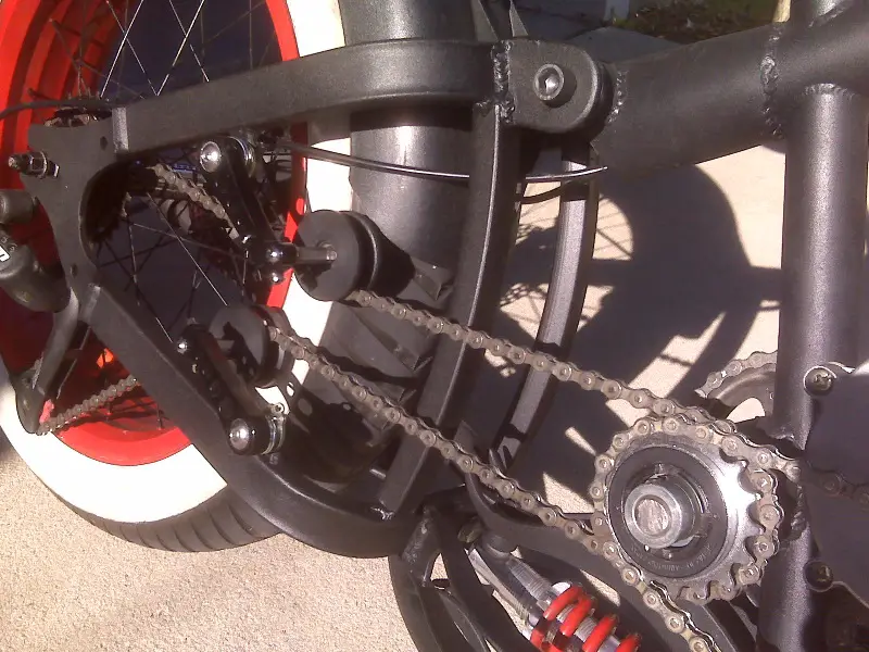

* You know if you go with rear suspension you are going to have to figure something out for a really well built spring chain tensioner.* Otherwise you will never keep the right tension on the drive chain. It will not stay on.* John

Good point, check out Brettmavrik's bike, he has it figured out! How useful this forum has been! I still don't quite know how his suspension works, seems backwards to me too, like somebody else said in his "orange coast chopper build" thread, but if it works it works! Anyway, like so many other things on his build ya gotta check out his whole chain tensioning deal he's got going on! If ya do it like he's done it, it makes sense.

The Derailleur IS the tensioner. =-]'
Those other tensioners just keep the chain from jumping around.
