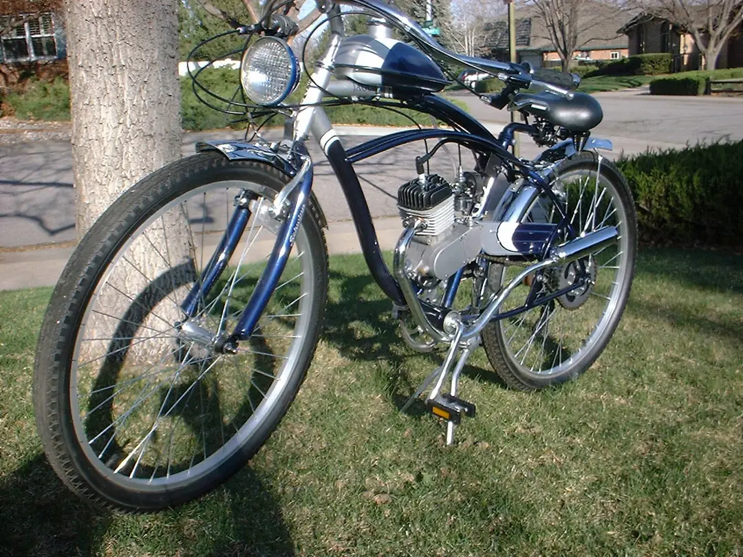

Spence,
I don't know what metal working skills you have but here is an idea for your Jag exhaust. The pipe is 3/4" elecrtical conduit, called EMT. I used the kit muffler, a conduit bender and wire feed welder to fabricate this exhaust. Hope this gives you some ideas to work with.

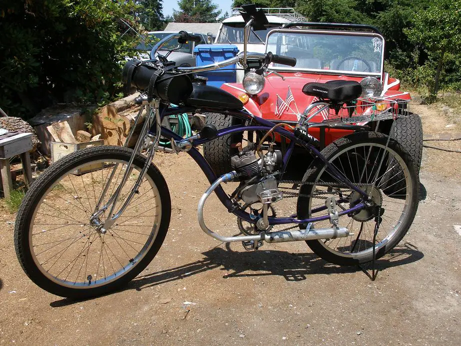

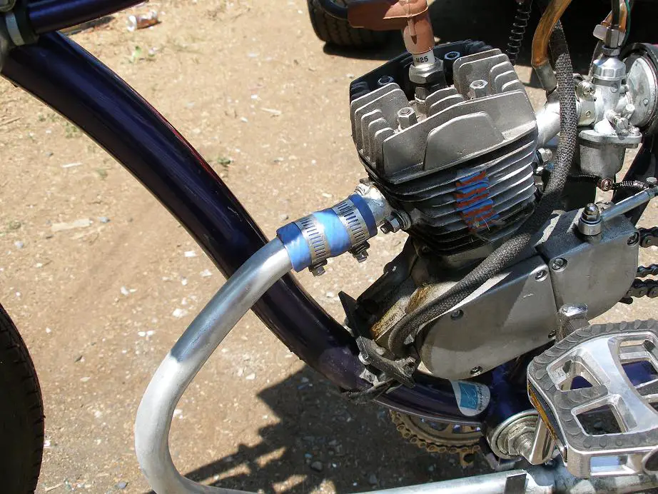

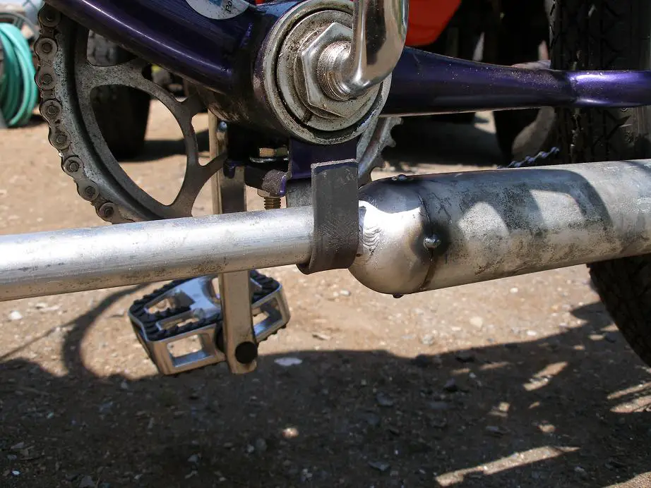

picked up this pipe off ebay for $25 made 1 cut to twist it. silicone hose good to 400 deg f. to join them together.. bent a piece of 1' wide steel i picked up at ace. around the muffler drilled a hole got a longer bolt for the lower idler mount and bolted it up there. also added a bracket where the kickstand was to support it and keep it away from the pedals. took all the baffles out of the muffler so now it act's like a expansion chamber. has alot more torque now and sounds more like a 2 stroke motorcycle not a moped.
