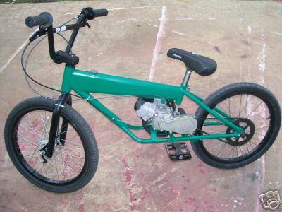

heres a pic of a bmx bike with a pocket rocket engine:

where can I get a pocket engine? when I search I keep getting the bikes only no engines only for sale. seems like that might be the way to go. Thanks

That picture does not have peddles on it. The pocket bike engines are usually too wide to frame mount and still have the clearance to clear the peddles. If you're going to a peddle-less set-up then it would be cheaper to get a minibike.
