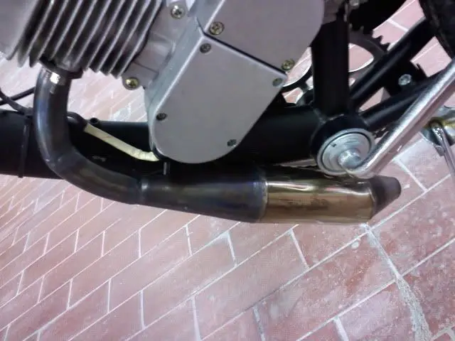

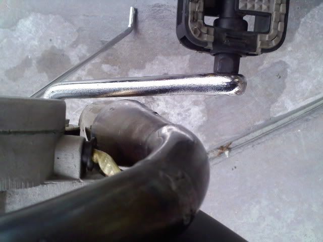

the motor i am building right now is a 66cc or an "80" if you are bad at math, the first thing in order was a pipe. so i built one out of stainless. i was amazed at the difference, i'm mostly a 4 stroke (harley) kinda guy, so i was expecting the first version to barely run. anyways the primary pipe is 1"d and the chamber is 3"d for 3" and the ends of the chamber taper from 3" to 1" in 2".(a picture would be worth at least this many words) now is when i ordered the dellorto 16/16, more on that soon.

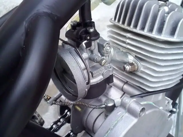

last but not least was the carb. it finally came in yesterday, (after more than a week) 73 dollars to your door. anyways, bolted it on to establish a baseline and get a plug reading. total crap! way too rich. pulled the air cleaner off, now it's rich but it runs. took out the main jet (82) and matched it up to some holley air bleeds. everyone on here keeps talking about buying all kinds of jets, well i'll let you in on one of my secrets. SOLDER!! go buy some resin core solder and a lighter, and some super tiny drill bits. anyways, i ended up with a .025" hole in the main and gained about 5 mph. wow what a difference, it just keeps pulling.

Very nice! How did you figure up the pipe?

that pipe was pretty much a stab in the dark

It looks outstanding. I look forward to seeing what you craft in the future

Cool!! Your jet size of 0.64mm seems about right. I have similar mods and run 0.65mm with the stock carb (I tried a Cheapie Delorto knock off and never could get that carb to work right, so I went back to stock.) and expansion chamber and increased CR with squish zone.
Actually no secret on the solder and drill method. Norman does it, Ghost0 and others do it.

it's been awhile. a little more port work, a new and (much) improved expansion chamber, and a speedo. with the original pipe and carb we were clocking 32mph with a 36t sprocket and a calibrated bicycle speedo. adding the new and improved pipe gets you 36mph with the 36t sprocket, and the race port with a 31t sprocket gets you 41mph (46mph on a 2deg grade).
