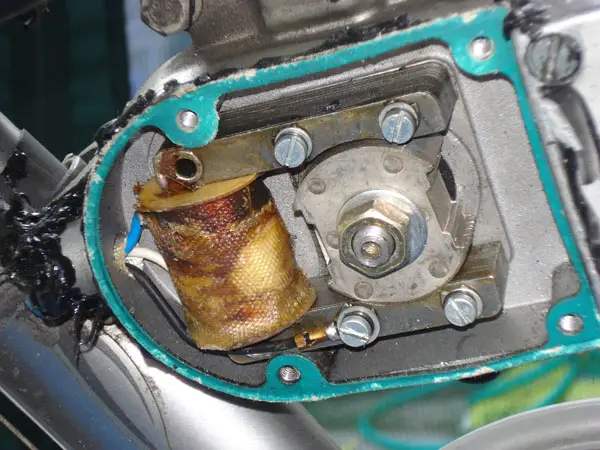

I think I found my real problem!
Highly unlikely...see my post in your follow-up thread.
