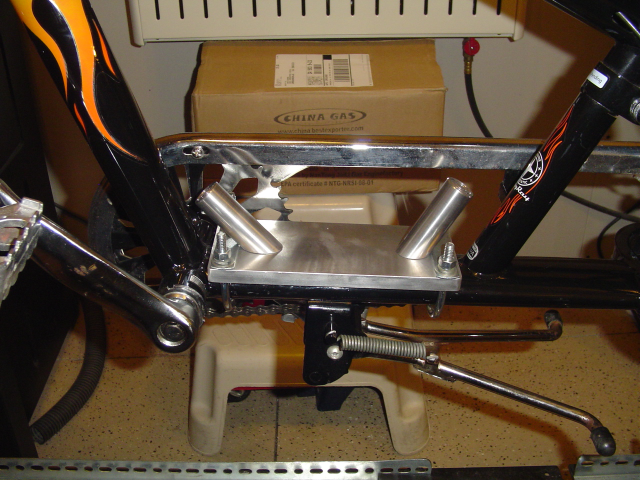

hey all im trying to build my own motor mount 4 a occ chopper bike anyone help me

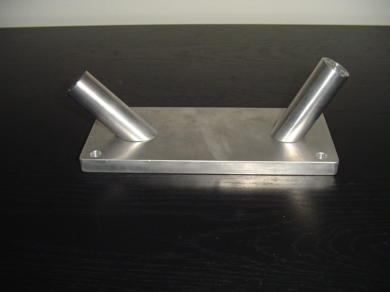

What do you have as far as shop equip? Such as welder, drill press ect. You are going to need more than just hand tools. If you don't have a shop you may want to buy the one from Barry off of e-bay. It should end up looking something like this. Engine needs to be offset 7/8" off the centerline of the frame to clear the 4 1/4" back tire. This one was fabricated from 6061 Aluminum.
John
ID:	10437   Click image for larger version

yes have that stuff thanks thats what i need to know the offset thanks
