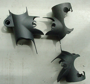

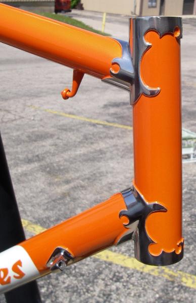

One more question, if you don't mind.
I came across a custom bike builder that uses custom cut lugs to build his frames, I was wondering what type of tool can be used to make them myself.
Tabagon,
Ya got me on this one...I have no idea.
