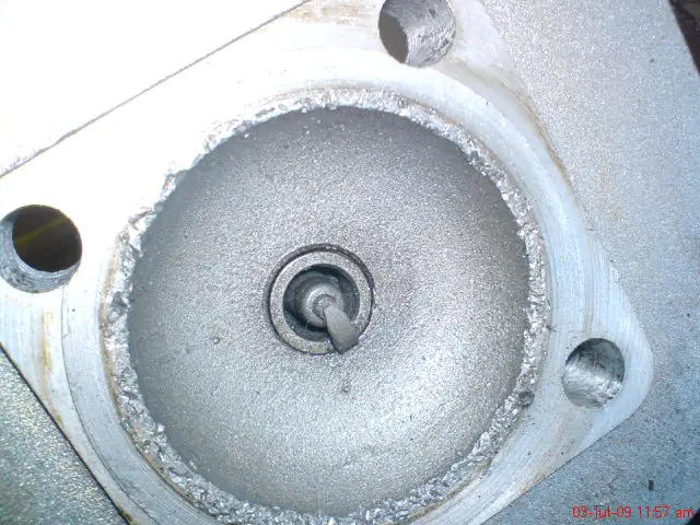

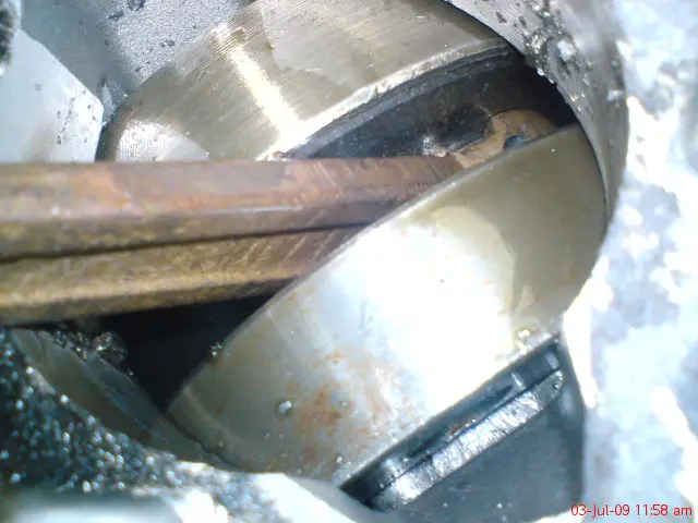

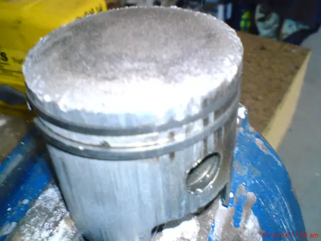

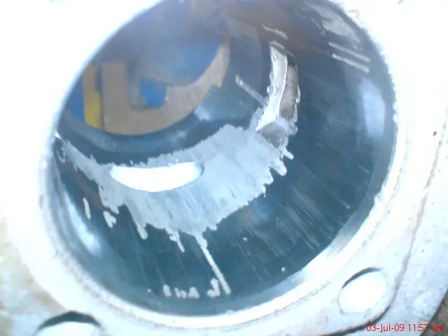

OK, Thanks team. Check this out. I also e-mailed back to my Aussie supplier and he said he will E-mail the photos to China and he will send me a new motor.
It looks like all the chrome came off the inside of the jug? Also there is bits of this metal? stuff in the bottom end too.
Steve
