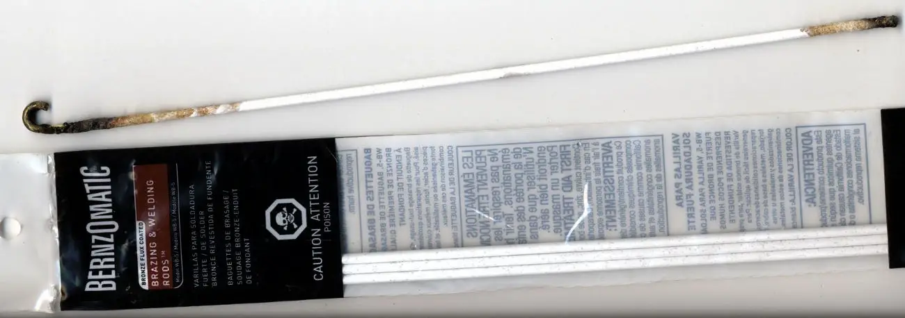

I got some Brazing rods at HomeDepot and I used some map gas, the yellow bottle.
I heat, and I heat, and I heat, and I heat, and I heat, and I heat, it wont melt and the pipe wont turn red. I must be doing something wrong.
Is this the right rod to use?
It's just the regular black pipe. The tack weld or sweding came loose inside where the header pipe goes into the muffler part.
