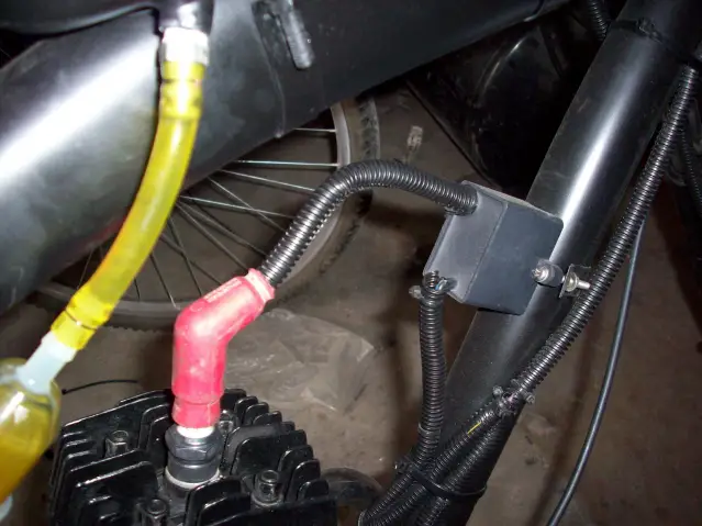

I am using a resistor plug wire and I have had no problems. It's a NGK off a Honda XR600.
