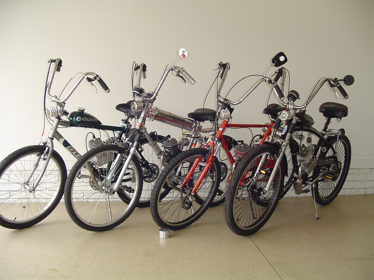

Originally Posted by sofasurferlinux View Post
I currently have a 10 speed racier style but would prefer an older bike. I'm not comfortable in the racing position, mostly because I'm over 50. Are the frames on most common bike similar enough that changing handlebars (and seat) is a possible solution? Or should I keep looking for a differant bike?
For me it is definitly a cruiser bike or Mt. bike frame with good cruiser tires and riser bars. Not ape hangers but Wald #880 riser bars, they fall in the perfect location for comfort. I have them on four of my bikes.
John
