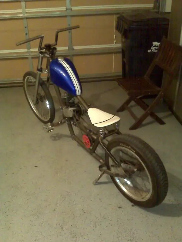

Hey Guys!
The Bobber Frames and Related Parts are now available For Sale.
To inquire and or order this unique builder's frame, motor mounts, jack shaft, custom seat, and cool factor to build and customize for your very own, just send me a private message or call the number on the logo.
Also, to follow along on this Blue Bobber's Progress, head to the last page of this thread. I'm updating as it happens.

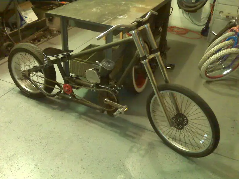

Originally Posted by bbb View Post
Keep the project going...looking good even though i am partial to the fullsize stretched cruisers. Maybe it could be your next project.

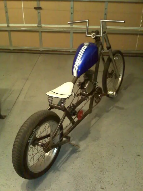

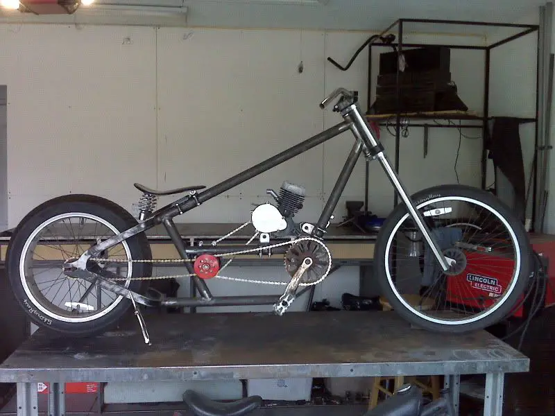

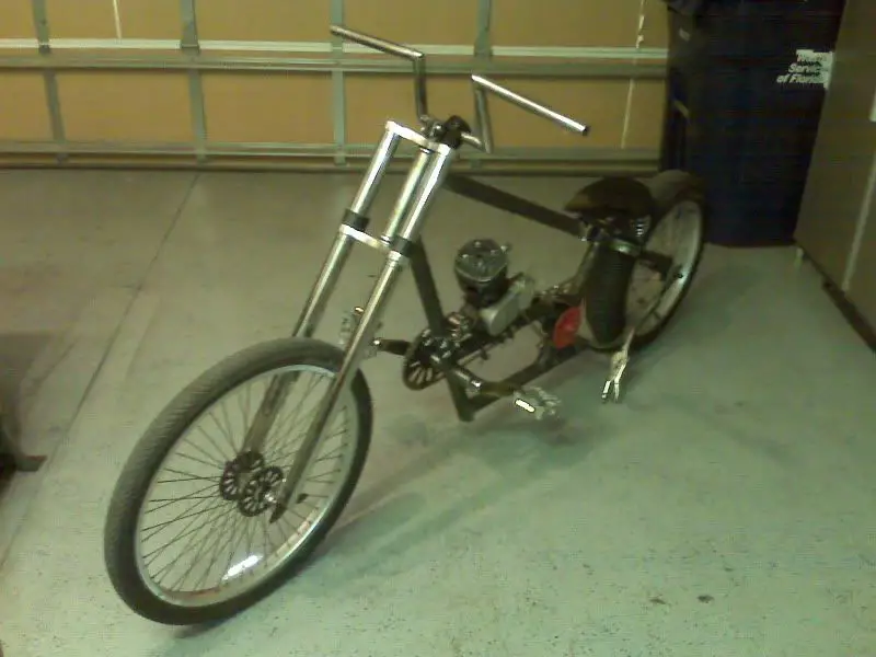

bbb, don't be mistaken...
This bike is Full Size.
I nailed the geometry on this frame. It's perfect. It has nearly a 5' wheelbase, a 38" handlebar height at the neck clamp, and up to a 36" inseam at the seat, (meaning the distance from the seat, at where someone's leg starts, to one pedal at it's farthest point from the seat ) and that itself is fully adjustable by sliding the seat fore and aft. Cool thing is, this frame still flies as a low rider. the seat unloaded sits at 25" when the seat is farthest back.
Plenty of room for comfort and no goofy handling....
I am also fabricating three different styles of handlebars to finish the look as I cannot find anything out there that I like. One will be a set of "BroomSticks"; 24" wide pin-straight drag bar. Second will be "Turn Downs"; 24" wide but turned down at the grips and swept slightly back. Third will be "Chimps"; a short-rise version of an ape hanger.
Gonna head out to the shop and finish the sliding solo seat bracket today.
I'll have more photos tonight.
Stay Tuned...

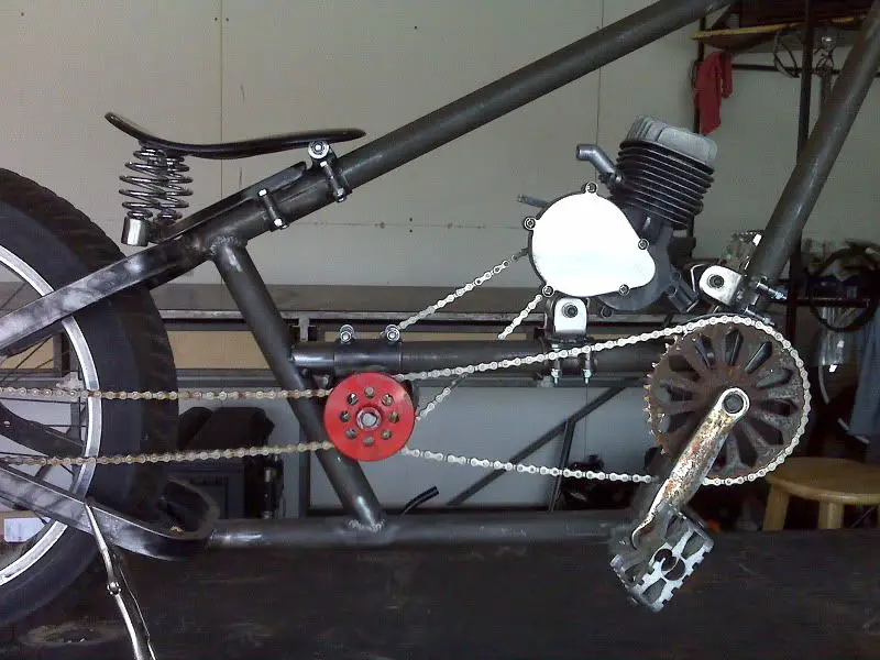

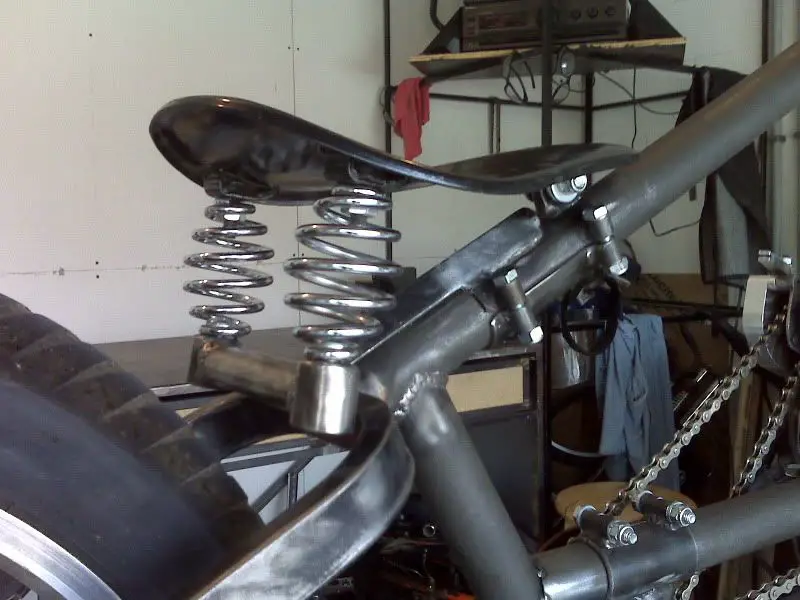

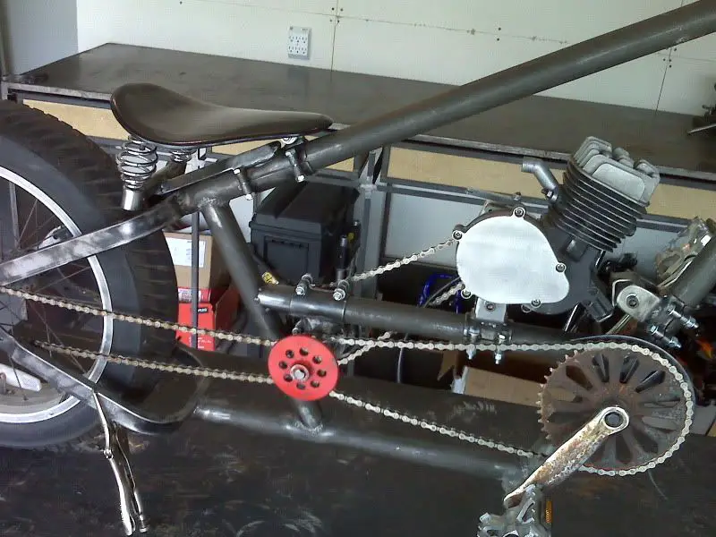

Got the Super Slick Sliding Sprung Solo Seat Setup Slayed.... =-]'
I like it. Nice and low profile, simple and effective.
Took her for a ride. She is very easy on the backside; even without the cushion in place.
Feels kinda' like an old tractor seat.
Werks fer' me... =-]'

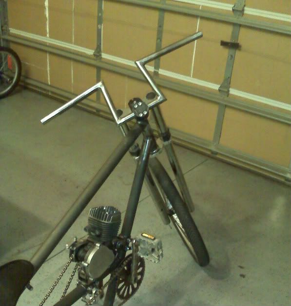

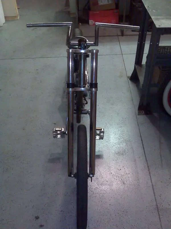

Look, Ma......
...........................Z-Bars.... =-]'

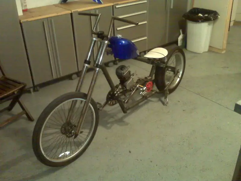

Thanks, DVD!

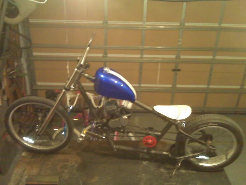

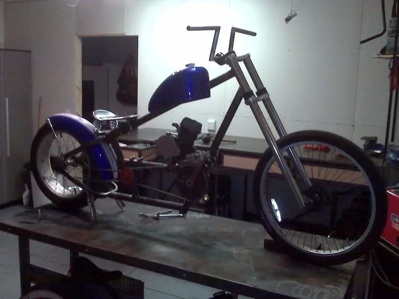

I'm Almost finished.
I don't have much further to go before paint. I'm going to weld threaded bungs
in the frame for the tank today, and do the final fit of the rear fender.
Then I dismantle it all and hit the frame with some love from the grinder with mop discs.
I will go up to 200 grit, and then I will hit it with a wire wheel. After that it's the M.E.K.
wipe down and primer. The frame is set in my mind to be Gunmetal. I was thinking of bright silver
but I don't want it to steal the show from the tanks and fenders. I can always change it if I like.
White will accent some other parts, and that color will be the corsage, so to speak.
