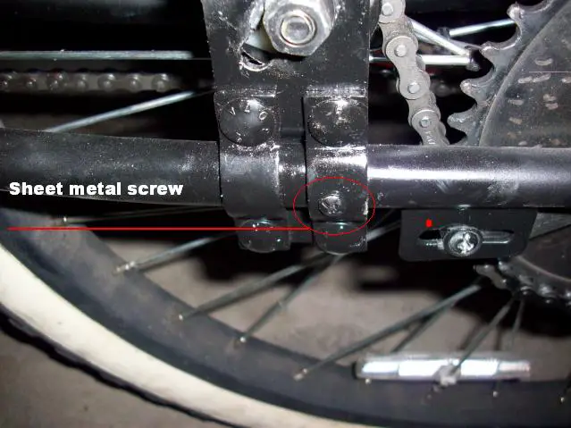

Most of us who run the tensioner will use a small sheet metal screw or something to keep the tensioner from twisting.
You can run without the tensioner but I like to use mine.
