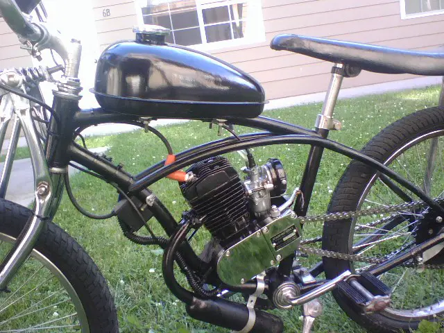

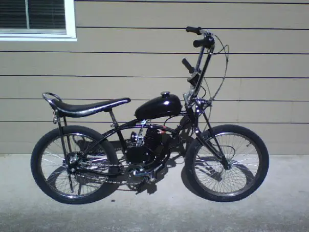

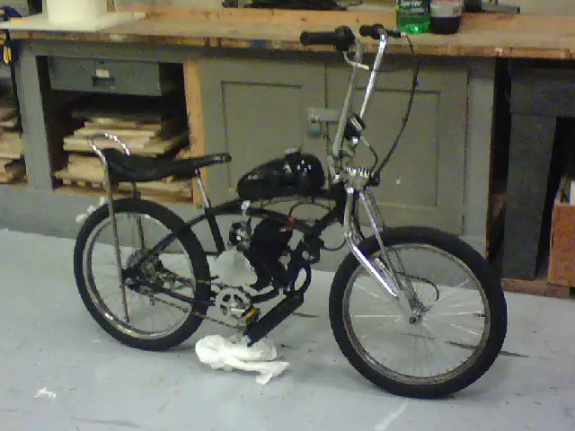

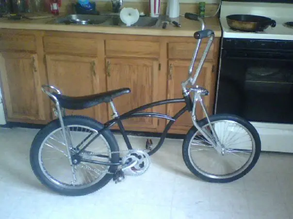

Hi. This is my first build.
Specs:
Frame: 1978 Schwinn Stingray Scrambler
Wheels: 20'' 48 spoke coaster brake
Tires: Kenda 20 X 1.95 tires
Pedal Drive: 34 T front 18 T rear
Engine: Rubber Mounted Grubee Starfire 50cc (48 cc) Slant head
Engine Drive: 11 T Front 36 T rear with 415 chain and no tensioner
Tank: Stock 1/2 Gallon
Spark Plug: NGK B6HS (So much better than the stock plug)
Spark Plug Wire: Napa Fiber Wire
Now has 78.2 miles on it.
I used to put cards in my spokes as a kid to make it sound like a motorcycle. Now my childhood dream has come to life.

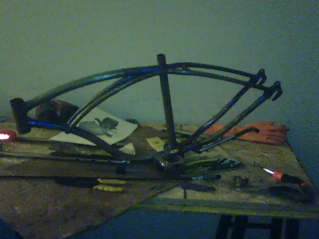

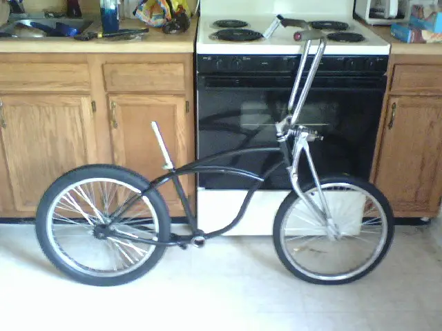

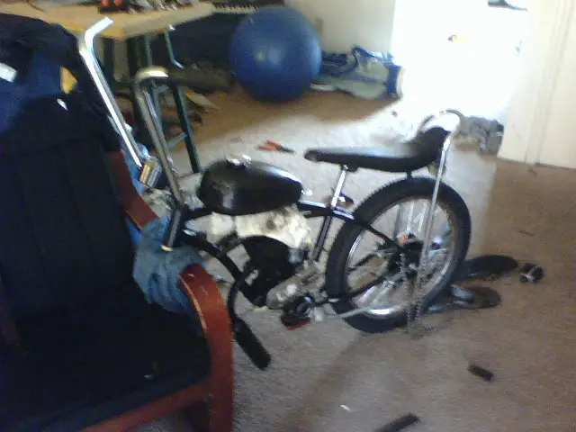

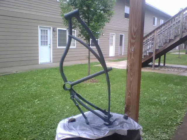

Default Build Photos of "Little Whizz"
Photos of the build
