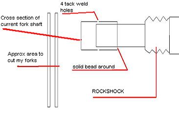

OK so here is what I have so far as to show you guys my intentions, I do not have a lot of Exp with welding so no need to flame me if you don't like the idea, just respectfully tell me if the idea is not good and why.

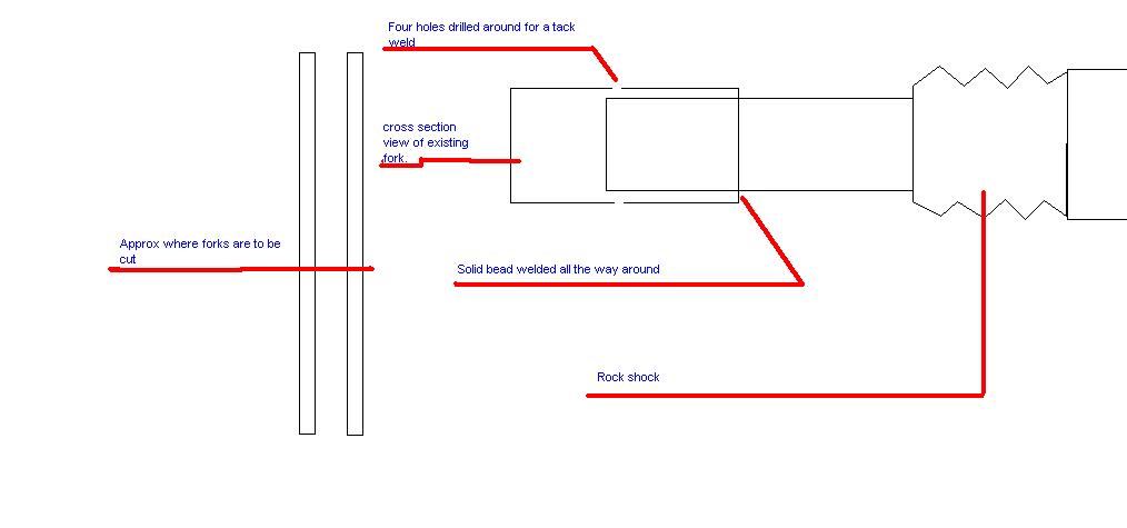

Here hope it is not too small

I have road on rock shox for years. There is some flex on them when you get on the front brake. I am not sure if they can handle that much of an angle? I would get a hold of the manufacture before purchasing them. I though I had a phone number I can't find it.

Any dual crown fork (Rock shox world cup, rock shox boxer, Marzocci Shiver, etc) should be strong enough, If you have a threaded headset, you can still find some dual crown forks around on EBay. Good luck.

Anyway, um the rake on the OCC schwinn is not very severe. I honestly don't think the stress will be too much. What I think I'll do though is extend the inside bar on the Shox so it will go further into the OG forks probably about half of the remaining length after I cut them. Then I'll use the same basic Idea as before accept I'll put a few extra Tac welds in for good measure. I am rather confident it will be alright, then I'll start on modding my rear end to a soft tail!
