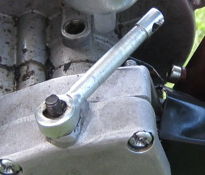

tried t o ajust the inner spring no luck! but now that ive loosen the flower nut i can roll the bike with out the back tire draging...and to ansewr your question yes the arm did move with the pin still engaged freely if carb wasnt there could have done 360 but now when i put it back on its stuck in this pos as seen in the pic

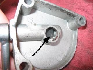

i just reread and have a question the where the clutch pin in is take it out and turn your motor to see if their is a little bearing the same diameter of the pin you might need a magnet to get it out, if their is no bearing you will need to get one. If their is one put the bearing back in put a little grease in the hole first and the pin. proceed below

Ok take the clutch arm cover off again,
in that picture the position of the clutch arm. If the arm looks like that and your clutch is not disengaged you need to tighten up the inner spring some more try a full revolution, take the flower nut off this time so that you can get a good turn on it. if you cannot tighten it up anymore with the flower nut off skip this step.

yes metal ball is in there behind the pin took cover off and took off flowernut tried to tighten sprig again idk if im doing any thing becuase i cant get the clutch to do any thing its like its seized in the engaged postion there is no dis engaging it where the arm is in the pic it woul be engaged it i pushed it counter clock wise jus 1/2" it would disengage but does nothing doesnt move... im ready to throw it off a 9 story parking garage nut i dont want to sooo much fun

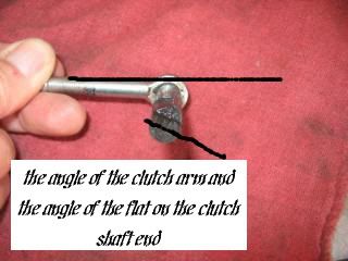

wait a minute your clutch arm? is the flat spot on the arm lined up with the pin flat?
if it is you will need to use a hammer or some tool to knock off the arm from the rod and reposition it so that it is running inline with the motor. pic below. I have mine off set a little bit.
if it is out of alignment reset it get a perm marker and mark a point on the clutch arm and the nut in a line so that you can see if you pull in the clutch and the arm is slipping on the rod and let me know.
