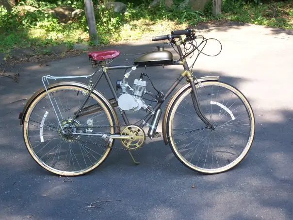

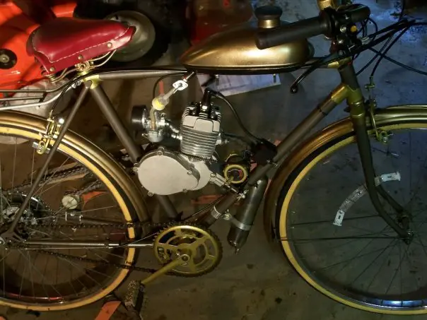

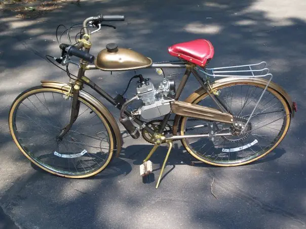

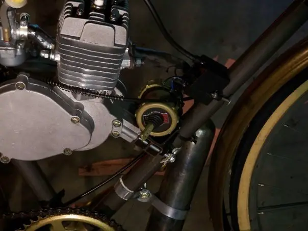

The attached pictures are of my 1st kit build. I put a 50cc china kit on an old British Hercules 3-speed bike. It was a little tricky because of the archaic frame and non-standard sized bolts and such, but I made it work. I had to bash the exhaust pipe around a lot to make it fit between the frame and the pedals... shabby results are shown. Not that noticeable from a distance, I suppose. Overall I was quite satisfied, although I modified the wiring a bit after the original pics were taken, as shown in the second two (the little unit I made with the on/off switch). The on/off switch later got moved to a more convenient position under the seat.
For paint I used Rustoleum in rattle cans. The frame is painted with a dark gray hammered-texture paint, and the ornate tubing connectors in a bright brass color. They have this stuff out with metal flakes in it that looks pretty damn good. I painted the cranks with it and it has held up to this day (though now the bike is in pieces and I'm busy putting the motor on the MoPOD Mk. II).
Comments are appreciated; I'm using a similar aesthetic approach to the new bike, so any suggestions or remarks about the old one are useful!

I noticed a different gas cap on your tank. Does it solve the leaking problem? Where did you get it?

Actually, both the muffler support and the cap came with the kit. The cap is the same one everybody gets, I just painted it matte black because I didn't like the chrome. In addressing the leaking problem, I determined that it was a build-up of pressure from a badly ventilated tank. What DID solve the leaking problem was adding a piece of rubber gasket to the inside of the cap so that it makes a better seal, and then putting a little pinhole in the center of the cap to allow vapor to escape. Not perfect, but no more leaking gas making a stink and wrecking my paint.
As for the muffler thing, I'm not even sure that's what those parts were for. They seemed to fit, so that's what I did with them. There were several other metal straps left over when I finished putting the thing together. *shrugs* Just bonus parts, I guess.
