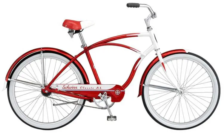

hi my name is sam, i'm 19 from dublin ireland and have just started getting in to the mb scene. i have just ordered myself a 2009 Schwinn Classic AL Cruiser, and a 69.7cc Starfire GenI GT4. it should all arrive on wednesday. i'll keep ye's updated. also if there are any other irish riders out there gizz a shout.
* Frame: Light Alloy Classic Cantilever Design; 7000 Series Alloy, Kickstand, Fender & Rack Mounts
* Fork: Steel Unicrown w/ Rack Mounts
* Bottom Bracket: One piece 24 tpi
* Rims: Alloy 26" x 2.125 x 36 holes
* Hubs: Schwinn approved 2-speed kick back Coaster Brake, 36H
* Tires: Whitewall
* Brake Levers: Alloy
* Stem: Phantom Alloy
* Saddle: Schwinn Classic Padded Dual Spring Saddle
* Extras: Two-Tone Paint, Clear Coat, Feather-style C/G, Schwinn Classic Padded Dual Spring Saddle and fenders
* Color: White/Red
i was slightly worried about mounting do you think it should go on without any problems or mods? all info would be great.
and i look forward to meeting you all.
cheers
Sam

Welcome to the forum! Keep us posted...that bike looks like a good candidate.

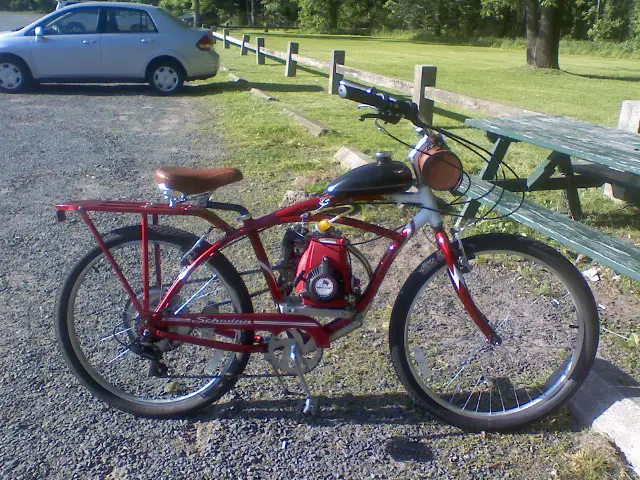

Howdy Sam, welcome. Great bike. I am partial to the cruisers. Gonna look sweet!. One thing you might want to consider is front brakes as they really, really help. I have a cheap, knock off version of Schwinn and on her 3rd engine. A lil TLC on the wheels and she has about 3K miles on and is still ridding great.
Great to meet you and post lots of pics!

Hey Sam, welcome to the forum,theres lots of great people and information here.The bike looks like it should work great,one thing you should do though, PLEASE either beef up the mounting tabs on the front fender or take it off,the original one will break,and the fender will wrap around the tire,and you can imagine the rest,its not good. Anyway glad you joined us, have fun. David

engine will fit and its a nice bike choice,secure the front fender.

thank you all for making me feel welcome and for the info. i had been planing on putting a couple of v brakes on it. and thanks for the heads up on the front fender problem. i just can't wait for my parts to get here.

Welcome to the forum. You may need need to make a front motor mount with a muffler clamp or buy an oversized tubing mount since your frame is aluminum and the down tube is fatter than steel. Installation should otherwise be straight forward.
I agree about the need for a front brake, especially since you will be riding in wet wx.
