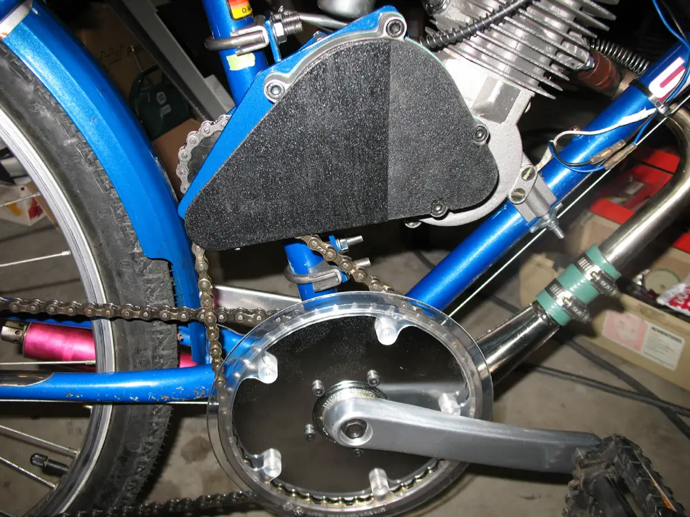

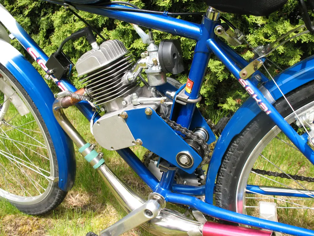

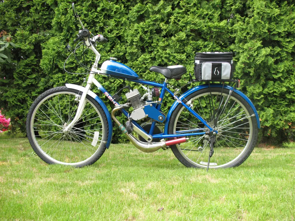

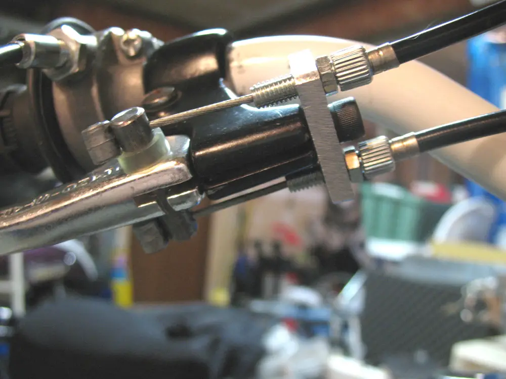

I like my bike. Now that Cruiser fixed the photos thought I would give you the good view.

that is a sharp looking motorized bicycle ghost. i really like the way you painted the jack shaft and the tank to all match. nice job (^)
Re: Ghost0's MB Cruiser
Very nice!!! Looks like you've done all the good tricks to it.
I really like the pipe!! thats what mine will look like when it's done. (just not as shinny)
Hows that jackshaft kit working out?

Max it out? Ya I found out I need to balance my wheels. It starts to vibrate pretty bad at 35mph.
Whoaaa!!!! (^)
That's one nice bike GhostO!
I'm going to check out more on your jackshaft Idea on how you've got the cranks not to spin with the engine. Major props!
Man. Oh Man. That's SMOOTH.
I LOVE how you're not revving out your engine.
You KNOW your engine is just loving you.
