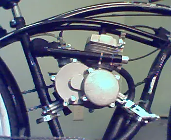

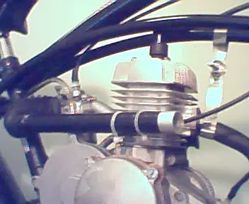

i would have liked to turn my engine around but my way was cheaper,easier and less time.

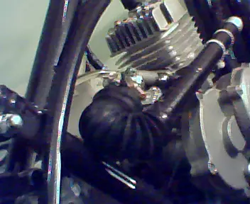

i used a rubber boot from a bike front fork shock,any one that will stretch over the end of the carb will do. and i used a 6" aluminum pipe, but plastic will work too.
i stretched the rubber boot over the end of the carb and slid the other end of the boot over a pipe and taped together with black tape and swiveled the pipe around the engine to point toward front of bike and used a plastic tie tied to clutch cable. and if you want you can put a filter on the end of the pipe,but i didnt yet.i am getting faster acceleration and overal top speed.

If there is any difference in power it's due to the length of the intake pipe. By making it so long and narrow it increases the velocity into the carburetor. You're not going to be getting any ram air effect until well over 60mph. So, don't think you're forcing air into the engine. It sucks in air in a lot faster than you going 35mph.
well then lets forget about the ram air effect,its getting plenty of air for sure which helps with faster acceleration and speed.it also helps to quiet the engine down.
its faster than when i was using the stock air filter plastic thingy because the air filter in stock location used to get clogged with alot of gas/oil blowback.so just moving the filter away from the carb will keep it from getting clogged as much.
