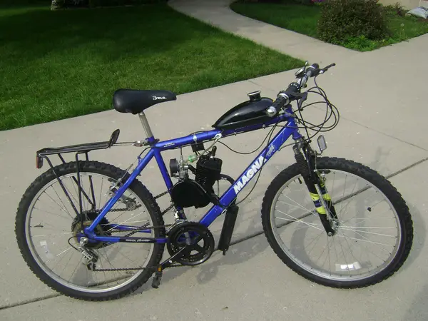

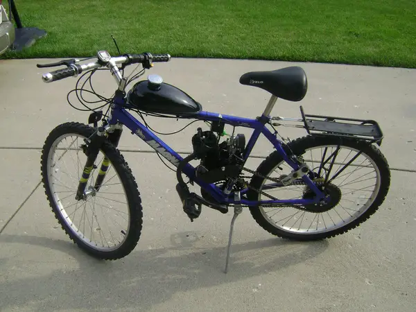

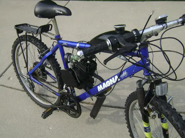

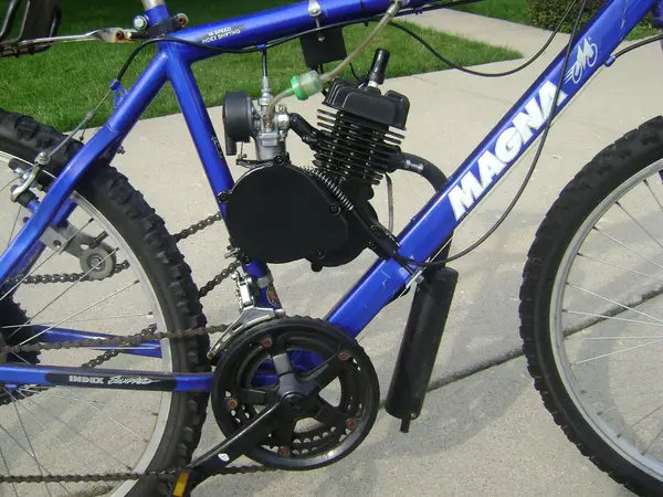

Some photos from my first build.

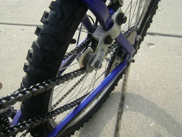

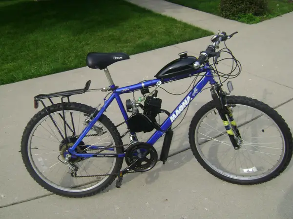

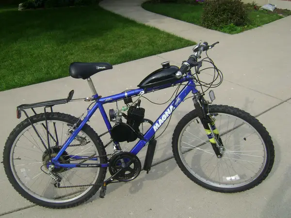

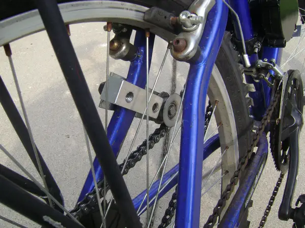

More photos. You can see the custom idler mount my father-in-law helped me fab up.

Old 06-19-2009, 02:59 PM
azbill's Avatar
azbill azbill is offline
Posts: 2,665
Default Re: First Build (square frame)
nice looking build
but...
I think the idler on the drive side of the chain is gonna be a problem
I can't remember why, but I remember reading it should be on return side
Bill
www.ezmotorbike.com
azgrampa@gmail.com
Old 06-19-2009, 04:22 PM
Clotho's Avatar
Clotho Clotho is offline
Posts: 305
Hiya!
Great looking bike. Welcome!
Actually, you have a dérailleur. You can get rid of the idler completely. Just adjust the length of the chain from the motor so that when you adjust the wheel it is the correct tightness. The dérailleur will take up the slack on the pedal side.

Old 06-19-2009, 06:46 PM
NunyaBidness's Avatar
NunyaBidness NunyaBidness is offline
Join Date: Jun 2008
Location: memphis tn
Posts: 850
Originally Posted by Clotho View Post
Hiya!
That only works when the rear wheel dropouts are sideways and not straight up and down like his appear to be. With no front to back movement of the wheel he can't do it like that.
Old 06-19-2009, 06:52 PM
burnclouds's Avatar
burnclouds burnclouds is offline
Join Date: Jun 2009
Location: ohio
Posts: 30
I can't move the idler do to the way the frame bends in just below where the Idler is mounted the chain actually hits the frame grinding away. I have a steel grind plate that I have to replace every 100 -200 miles. Now being on the drive side I do have to re-adjust the idler position every 50 miles or so. This is definatly NOT the ideal bike for an in-frame 2-stroke. But it's what I had and it gets the job done.

Old 06-19-2009, 09:06 PM
Clotho's Avatar
Posts: 305
The dropouts are at an angle. I have never seen any that were vertical. Even with the mounts at an angle I have been able to adjust the tension on the chain in this fashion. I have 4 bikes. 3 have angled dropouts. None have an idler.
__________________________________
Old 06-19-2009, 10:00 PM
captainrichhill captainrichhill is offline
Posts: 203
I have a derailer and I don't have any fwd/aft adjustment either. I have to use a tensioner also. But, I'm pretty sure that you want the tensioner on the return side due to the force of the engine on the chain is felt on the top run of the chain and slack on the bottom run. (during normal acceleration and cruise) The opposite is true for decceleration without the clutch pulled in.
Old 06-19-2009, 11:06 PM
chrisme chrisme is offline
Join Date: May 2009
Location: Maine
Posts: 389

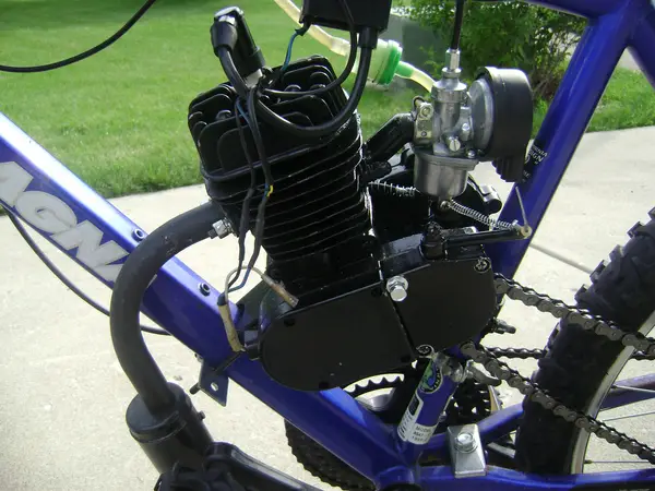

DON'T put the idler on the drive side. Not only will it steal power, the force on the chain will eat that plastic gear in no time at all.
Also, your coil is way to close to the top of the cylinder head. The heat will kill the coil, and possibly melt the wires.
But that is one good looking bike! I love the black engine. I should have gotten the black....
Would make it harder to see leaks though.
All times are GMT -5. The time now is 09:16 PM.
