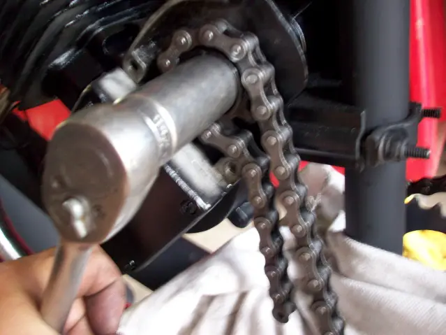

Hey,I Can't Figure Out How To Get The Chain Into The Engine Sprocket.. It's Like It Doesn't Fit..
Got Some Pics To Show You Where I'm Stuck..
The Arrow Is Pointing To The Part Where My Chain Can't Fit.. I'm Using The Stock Chain That Came With My Kit..

Oh! So I Gotta Use The Spark Plug Tool To Turn The Sprocket To Feed My Chain Am I Right?

There are 2 ways I have done it, one is to feed the chain through with the master link out. And the other way is I took off the sprocket. Just don't loose the key if you do that.

Remove the spark plug so it's easier to turn, or push the clutch arm over (get a helper) and use the tool to feed the chain through.

ya you gotta roll the chain on with master link off just pull clutch and turn it on

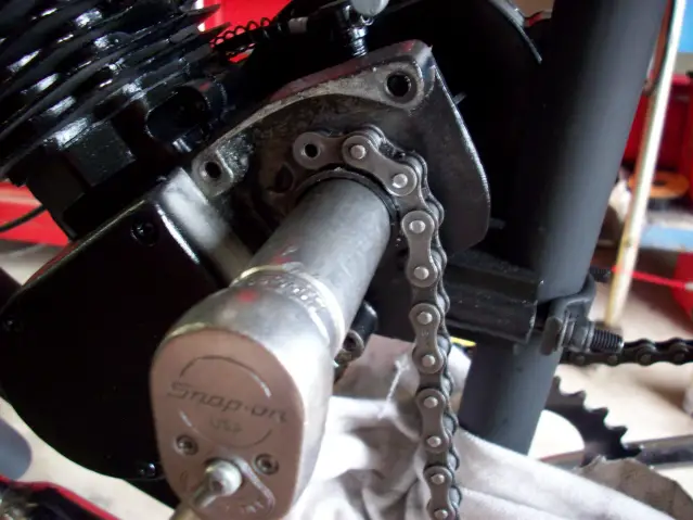

Pic 1)With the spark plug removed and the master link off and clutch cover removed start the chain on the sprocket with a few teeth.

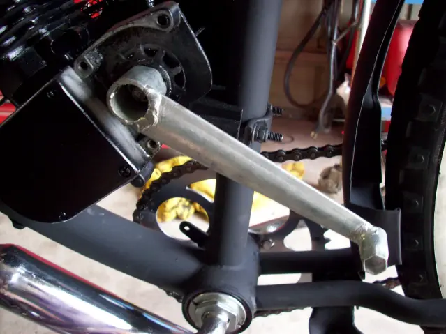

Pic 2) With the spark plug tool provided with the kit or a socket and ratchet turn the nut on the sprocket.

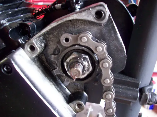

Pic 3) Keep turning the sprocket until you have feed the chain enough to were you can reattach it to the other end.

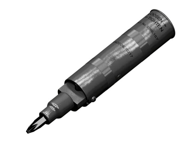

Pic 4) Spark Plug tool provided with most kits
