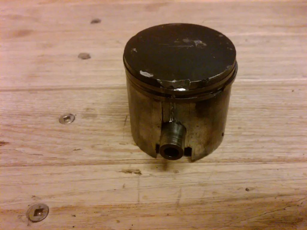

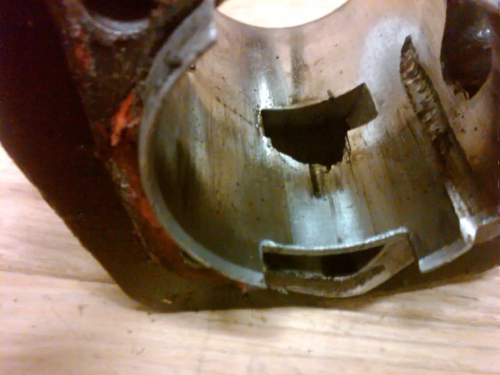

Well my china motor has finally been destroyed by a 3 cent part... The retaining clips broke (at the right angle bend) and got in between the cylinder and the piston... Two days later I was riding my other bike and the bottom end bearing went and trashed the cylinder and piston. Just my luck... Now im gonna repair the engine with the bad bearing and sell it.

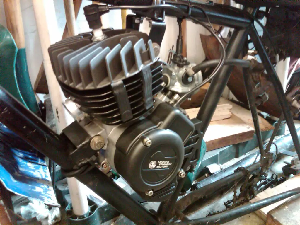

I purchased a Morini 5.8 hp S6 engine from herdan on monday and already have it mounted on my black bike Currently awaiting a 36 tooth sprocket before I can test it out

Post some pics of your mounting if you can. I'm very curious.
Put something FUN between your legs..
Old 06-19-2009, 10:22 AM
europorsche914's Avatar
europorsche914 europorsche914 is offline
Join Date: Jun 2008
Location: Lancaster, PA / Newark, DE
Posts: 169
Default Re: Death of a China 70cc... Now onto Morini 5.8hp

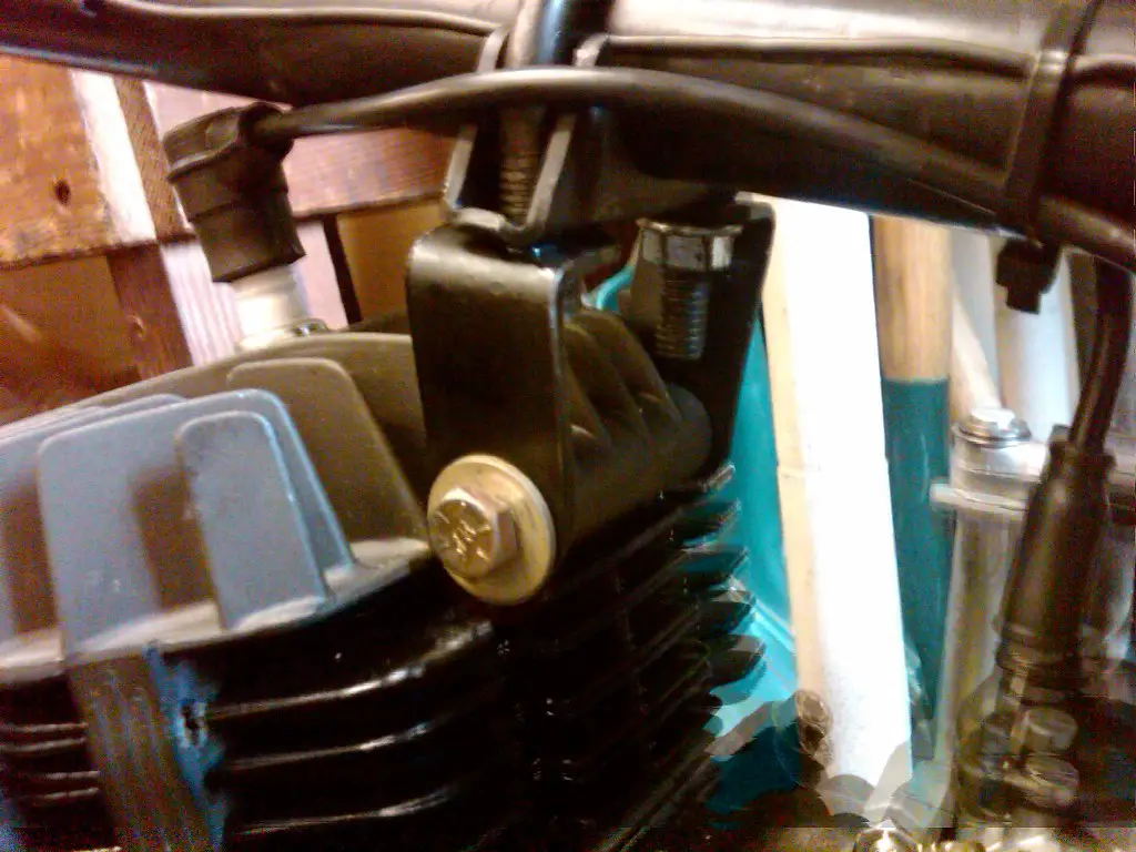

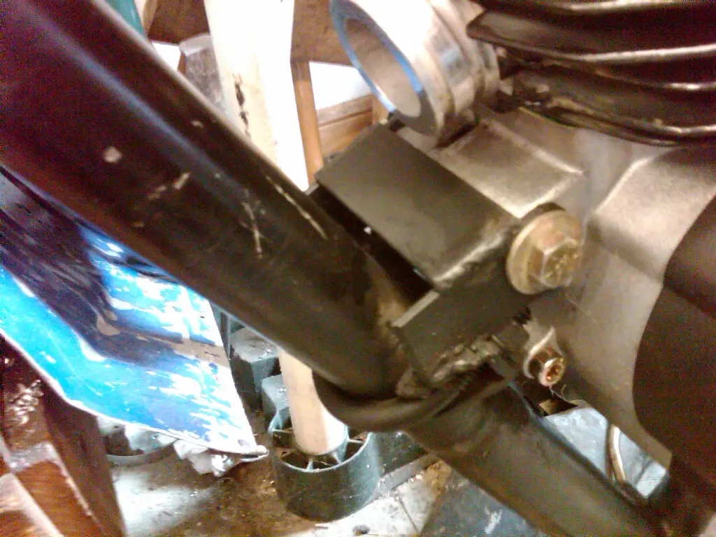

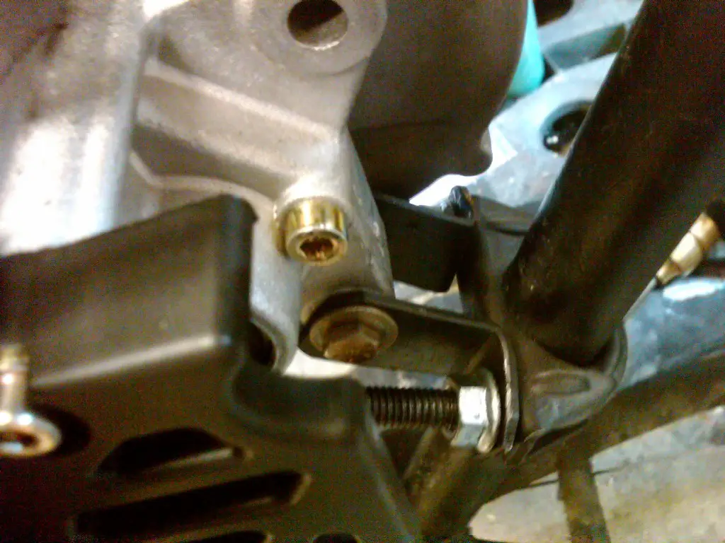

Here's some pic's:

Looks good! If I were to suggest anything, I think you should try a 44-47 tooth sprocket. A 47 is my all time favorite for the streets. It still has plenty of bottom end, climbing power and top end. When I tried a 36 it took a while for the bike to hit the power band but when it did it was definitely too fast on the top end (55 mph and still not hitting its top speed) I have a high quality 36 tooth from Kings Sales and Service if your interested.
