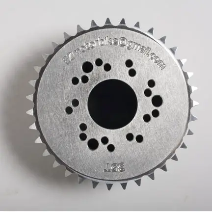

When I designed my CNC 3 way mount sprocket I settled on 35 teeth
as the best compromise.......
44 tooth = 27.9 MPH at 6500 RPM and 26" tires
35 tooth = 35 MPH at 6500 RPM and 26" tires
35 tooth at 5000 RPM = 27 MPH
35 tooth at 5500 RPM = 29.6 MPH
35 tooth at 6500 RPM = 35 MPH
35 tooth at 7300 RPM = 39.3 MPH (~True redline on a stock 66 cc)
The Chinese 66cc 2 stroke engine does not have enough power to
pull a smaller sprocket than this without losing a lot of bottom end
and it won't go over 40 mph anyway cause it doesn't have enough HP
Speed is not the only issue with a smaller sprocket as you are dropping
1300 RPM at 28 MPH for a much smoother and comfortable cruise
My sprocket mounts with the small Grubee style rag joints and has
a larger center hole diameter of 1 11/16" that matches the rubber rings
It also mounts with the larger diameter PK / Raw rag joints or
can be Clamshell mounted by the large 3 holes
Reversible offset mount 1/4" thick light weight aluminum 7075
Sells for $29.95 for local pick up In Orange County and
$5.95 shipping & handling for 2 day Priority Mail envelope with bubble wrap
Can ship 2 sprockets for only $5.95 total
Buy three sprockets and get FREE Priority Mail shipping
PS: My CNC 35 tooth sprocket is 0.8 mph faster than your flat? heavy
steel 36 tooth BGF which has badly formed teeth
