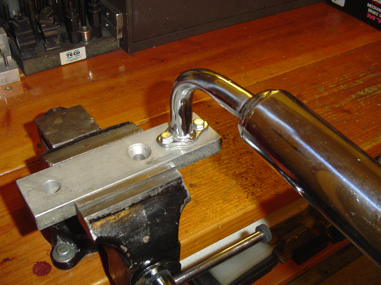

If you need to put a slight bend in your stock exhaust, I will give you a great tip on how to hold it down when you bend it.
Use an old piece of steel plate, channel Iron, anything you have laying around. Drill the hole pattern that fits your muffler in it. Bolt it down solid with a couple 6 mm or 1/4" bolts. Clamp that in the vise and bend away, That way you can give it a little bend without it pulling out if the vise.
John
John
Good idea, John. I put two 1/4" bolts in the vice, really tightened it and that worked too.

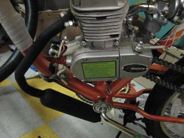

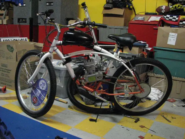

]Hello all Beetle Juice Happy thanks to all you who replied to my question's You all helped me greatly to make the right decisions. I use to build experimental airplane the one's you actually fly and ultralight's and still will when i run across another. But I ordered 2 motors and Monday of next week I will start my second build. I have enclosed my muffler repair that cost me 10.00 the welder did a great job I think so riding I will go tomorrow I have ridden for about 30 minutes now I will check the bolts.
